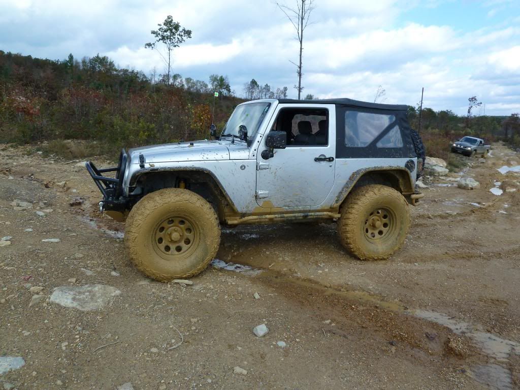

Ok I'll play, 2" old man emu w/ 37" kevlars:
http://i262.photobucket.com/albums/i...1/P1000363.jpg
http://i262.photobucket.com/albums/i...1/P1000413.jpg
http://i262.photobucket.com/albums/i...1/P1000426.jpg
http://i262.photobucket.com/albums/i...1/P1000479.jpg
http://i262.photobucket.com/albums/i...1/P1000468.jpg
This setup works but I'm running a little more bumpstop than I'd like. I plan on going up to a 3" lift so I can get more flex out of my rig, just not in the budget at the moment after the tires and axles, lol.

How the heck do you run 37's with a 2" lift? I have an 08 JK with the 2" Mopar Lift. Keep in mind I have the stock fender flares, but how big of tires could I run? What if I got flat fender flares? I'm mind blown right now.
SlvrJK Oct 26, 2011 05:39 PM
Haha I knew that would get someones attention :D I like my rigs low.
The flat flares free up a lot of real-estate, and I'm not affraid of cutting sheetmetal. I running 2.5" extended bumpstops from teraflex front and rear, and have trimmed ALOT of material from the pinch seam in front the the rear tire.
I have the 2" old man emu light duty coils and shocks, jks track bars, rock krawler front lca's...and b/c of all the armor I have I'm trully only running 2" of lift, not the 3" some people get from these springs on a lighter rig.
The rear tires do rub a little at full stuff but it's pretty minimal so I'm not to cocerned. Like i said i do plan to go to about 3" of lift so i can get some uptravel back and a little more flex.
I woudnt hesitate to run 35's on your setup w/ some trimmed stock fenders and some extra bumpstoppage out back if you don't want to trim a bunch.
