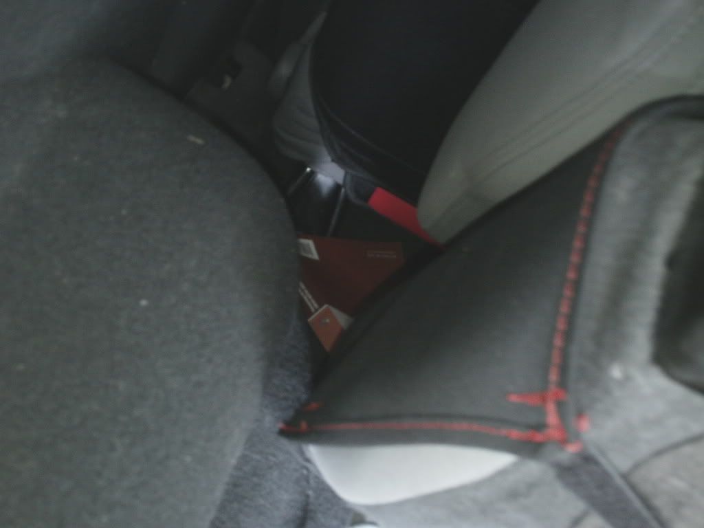

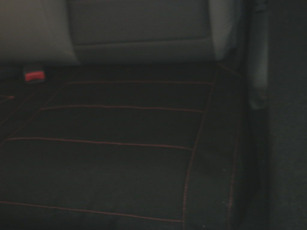

It's not a towel with a piece of elastic, and it's not a blankets scrunched up and sewn to drape over the seat, I spent 3 and a half hours today getting half of my rear seat done.
I used black Sunbrella canvas, red thread, some half inch scrim backed foam, and an industrial Juki sewing machine.
I measured the rear sections of the seat, cut out my pieces (roughly) sewed on the foam for the two seat inserts and cut out the finished pieces and began sewing them together. After getting the main piece of the bottom on, i figured why no make it more, "my own". Here is the only pic i took today of the bottom cover, i will definately get alot more pictures tomorrow, i just wanted to tease.

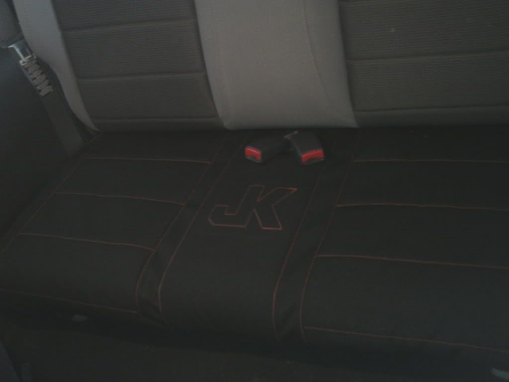

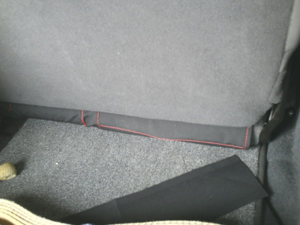

I make alot of "soft" mods covers, cushions, etc..

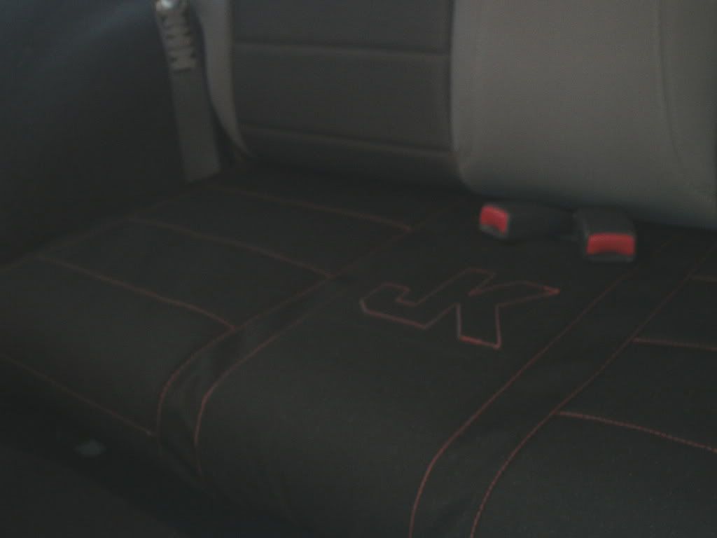

Here is a couple pics of the cover i made yesterday, the fit is great! i just need to make the two areas where the seat inserts are tighter.

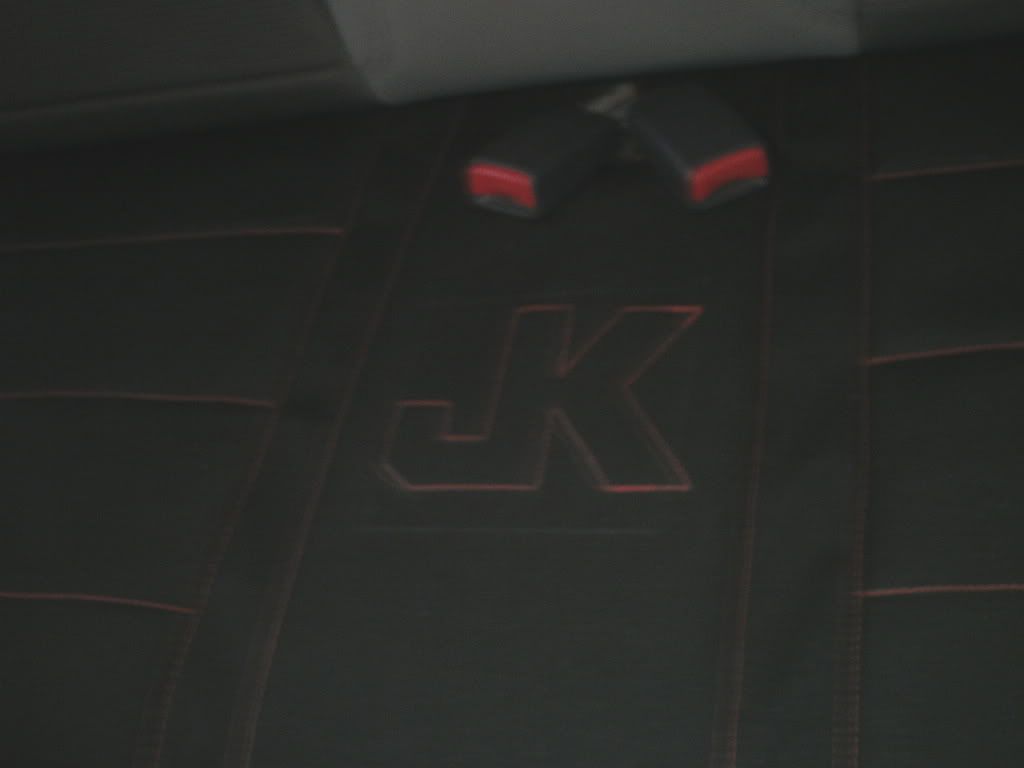

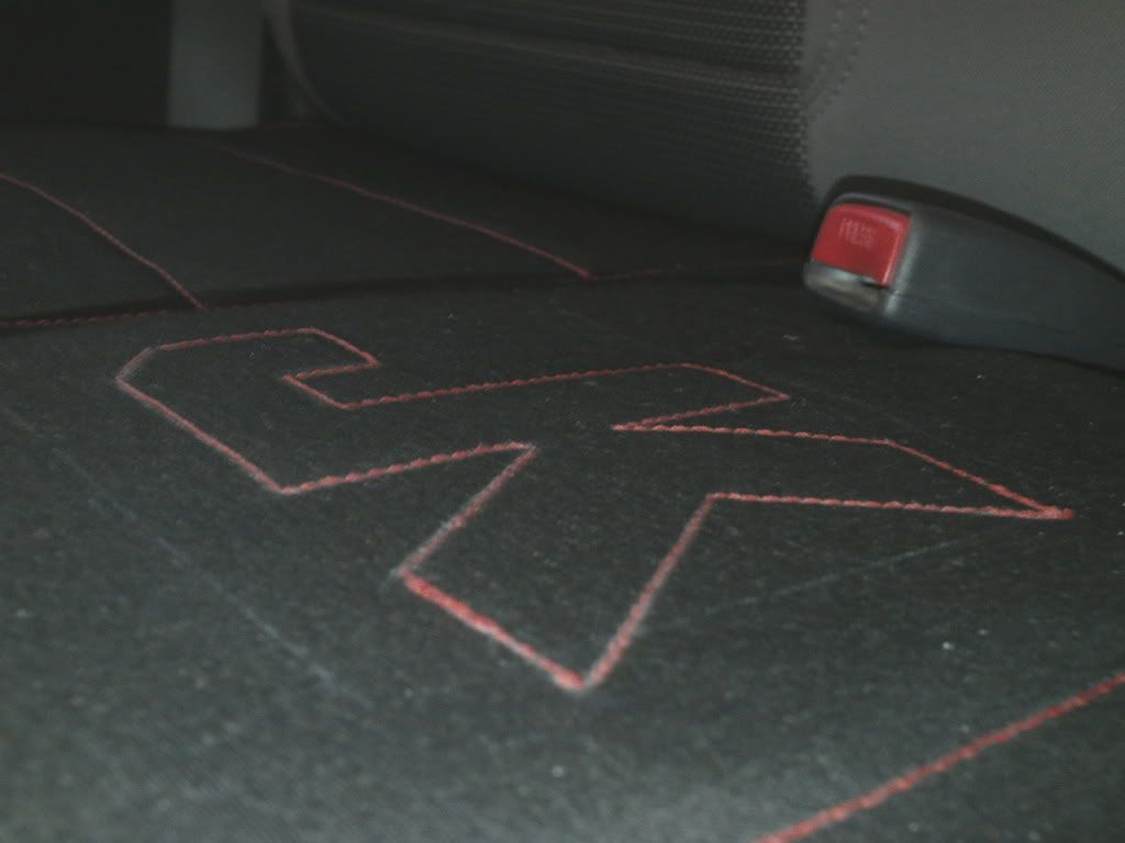

Hand drawn, and stitched very carefully

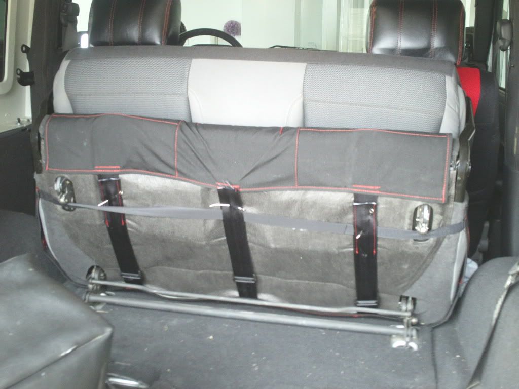

The cover wraps around the back of the bottom of the seat
I used my loop and velcro Seat belt material and sewed on some heavy duty velcro, but after actually installing it they were twice as long, so for the time being i just pinned them and cut off the excess.
Some of you may have noticed that little strap across the width,
There i just ran a 2 lines holding strips of velcro so i could pull the side pieces tight
With time i'll get the top section done, but for over three and a half hours into it, i'm happy.
And this canvas material won't fade, won't fall apart, and it's waterproof. Plus, if i rip or tear it up i can use it as a pattern to make a better one.

Wow!!!! You could have a big business on your hands with these!!! Looks great!
