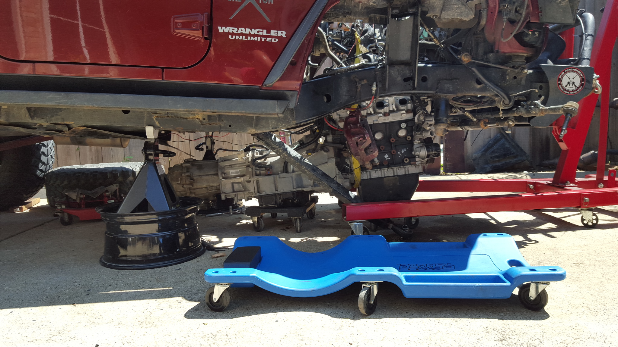

Two weekends ago I pulled the axle out, and pulled the engine/transmission out separately.
I removed the supper charger off my old engine and set-up the new engine with the SC.
Here is a picture of the valves of the new engine when I switched the valve covers around. She is clean!
I rolled the new engine under the jeep and I will lift it into place once the parts arrive.

Well, my wife went out for 3 hours so I decided to try and get the engine on its mounts in that window.
I have took some pictures of my progress. I did not run into any real issues expect that my crane is not long enough. I end up using a jack to push the motor back so I can get it aligned with the mounts.
The engine is too far forward so I wedged a scissors jack between the front cross member and the jeep.
Got it in after about 2 hours of jacking around with it.
