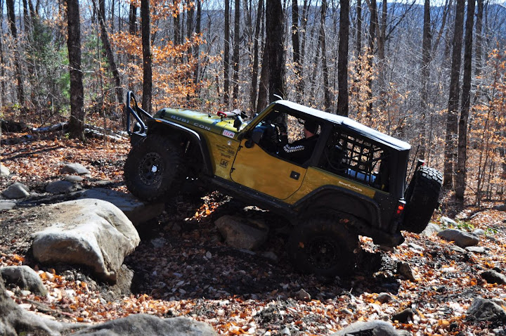

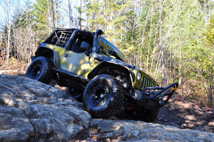

Here you go. This is a TF 2.5 coil lift (including the supplied bump stops), plus a TF 1 inch spacer on the back. The tires are BFG KM2s 345/75R16 (about 36.5). Some trimming on the rear pinch seams was required.
Good luck!

Nice Rig!
Looks really good.
