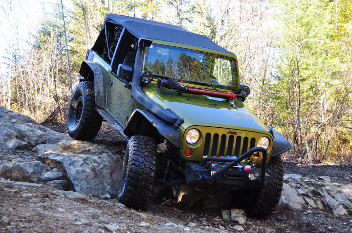

Originally Posted by Trick Cyclist
Here you go. This is a TF 2.5 coil lift (including the supplied bump stops), plus a TF 1 inch spacer on the back. The tires are BFG KM2s 345/75R16 (about 36.5). Some trimming on the rear pinch seams was required.
Good luck!
Not trying to steal the thread, but how did you mount those lights on your Rugged Ridge bumper?
