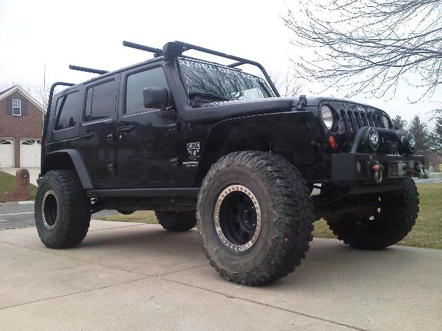

4 showed up and I got them mounted now to dial in the balancing having trouble with the right amount of airsoft pellets anyways heres a pic.

Go to dynabead and look at their chart from the website to how many oz. I think it was like 20,000 airsoft=43oz or something

I looked at a few charts cant remember if theirs was one I started with 12oz and it shook like Hell dropped it to 8 and its drivable but shakes at 40 and wobbles around 50. I cant tell wether to go up to 10 or drop to 8. Supposed to leave Thursday for Moab so I dont have the time to keep guessing.

I have 17 racelines and 37 mtrk and 10 balanced mine perfect.

Dynabeads site says 10 also guess ill try it. 8 oz of powder balanced my 37 coopers fine when they were on factory wheels. Thanks for the help
