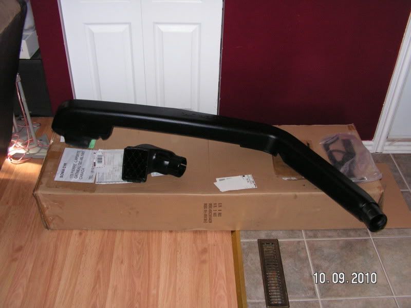

i just bought a snorkel with air ram on ebay .
that snorkel is a imitation of the aev and the price is mutch cheaper .
it took me 2h15min to installe it and it was my first time .
the price 115$ buy it now !
plus the shipping to canada 227$ to my door .
here in canada they are 439$ + taxe .
here's some pictures

have you tested it yet? just wondering because in this photo it looks like a
small gap in between the hood and the snorkel itself. or is that how it is
suppose to be? just wondering

it's suppose to have a gap of 1/8 .
for the under hood i will take pictures , i did not tested yet but it will come
it look to seal very good but like the aev you have to put some black silicone .
i downloaded the aev instruction ( pdf ) on quadratec for the installation .

The AEV and by the looks of this system are very water tight. The snorkel fits right into the stock air-box intake hole. You are required to seal up the connection between the snorkel and airbox and all the stock box holes with silicon sealer. I don't have any connection pictures...but I did not have any water or mud come into my Stock box after this deep dive!
