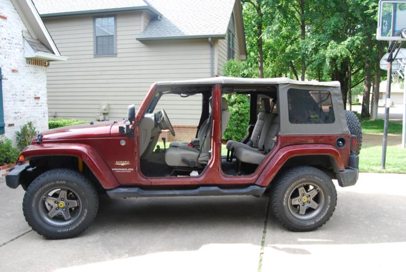

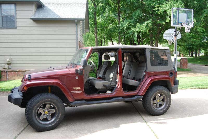

On Saturday my friend and installed the TF Performance Leveling Kit and OME Nitrocharger Shocks. This was our first install and it went rather smoothly. The rear took us two and a half hours. The front took longer, but we were slightly lethargic after lunch at Ron's Hamburgers. The ride is nice, smoother than stock I think. Below is the after pic, we had it all jacked up and loosened before we remembered to take before shots. Sorry. But you can tell a big difference.
If it looks like there is a slight reverse rake that may be because we also installed 1/2" TF spacers up front in anticipation of the Rock Hard front bumper that my friend is supposed to sell me (used, but for less than half the price of a new one).

Thanks you, it feels good knowing I did the work myself. Next step is to get front adjustable lower control arms, probably Currie from Northridge. The caster in the front measuring at -3.3 and -3.6. Most likely will wait until the new bumper, see how it settles. The steering doesn't seem flighty at the moment. Plus the driver side camber came in -0.9 and the ball joints are fine, so I may have to address that issue first, figure out what's bent or get offset/adjustable ball joints. The positive side of the camber issue is that I can prove to my wife that it is not at all related to the small lift, allowing some more wiggle room for upgrading.
I recommend to all those who think they can't do something like this to give it a shot, start with something like this, just springs and shocks. Something you can do in less than a day. That, and have a friend with a floor jack. It's fun and you learn a ton.

Here are some before pics, sort of.
