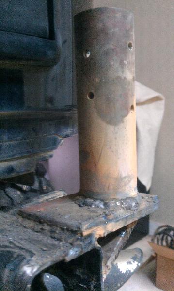

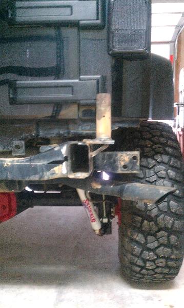

Ok so I changed were I am mounting the hinge so the cut in the bumper will be diff. Will post pics of the new cut in a while. Meanwhile here it the bracket I welded up and first part of the hinge.

I am using scrap steel for most of this. Will post back soon

Should work, but one word of advice, make sure before you weld you've ground down to clean shiney metal. It will make your welding a lot stronger, and easier to weld too. Can't wait to see the finished product.

Yeah I did sand the paint off with my dremel before welding.

Also went ahead and built me a hitch from my tow hook bracket.
Cut the tow hook out and welded in a $10 hitch recover from the auto parts store. $10 hitch can't beat that.

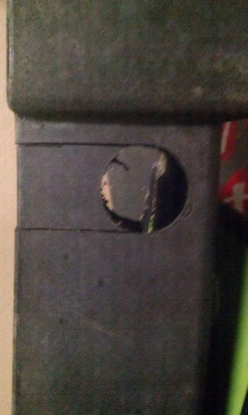

Ol if anyone cares. Bumper is back on you have to cut out some of the back but it will depend on what ur bracket is like. Going to cut some pieces and plastic weld then in to cover the holes.
