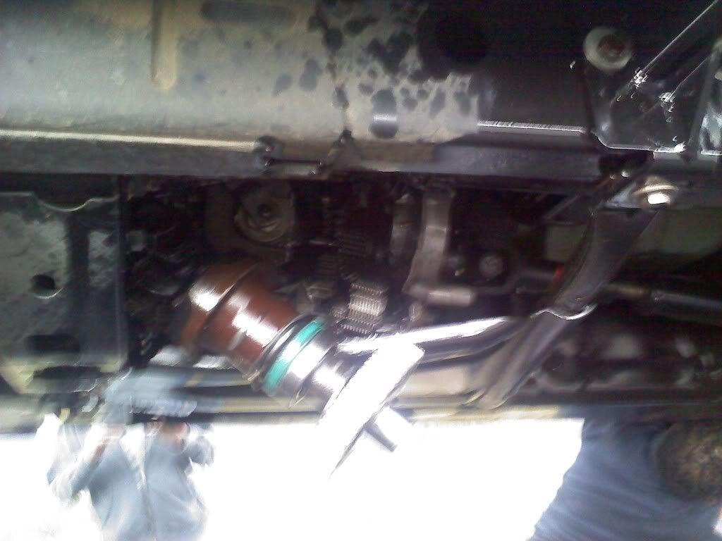

My friends and I was coming back from the desert. Not wheeling but just a good day of shooting our guns. On the way home we were talking about the transfer case problem that Eddie Wayoflife was show on his Moab video. Not 5 minute later this is what happen to my transfer case on the hwy at 65 mph...

Folks are saying aftermarket front DS with improper pinion angle is what causes the TC to fail.

Hmm, looks like an aftermarket shaft adapter type with the stock flange. Correct?

Curious as to what lift/caster/driveshaft your running. Also have you ever serviced your double cardian on the driveshaft?

holy cow!! glad that you're okay. looking at the pics, i see that you still have your factory front output shaft on and can only assume that you have some kind of adapter or flange mount. if i could guess, this is part of your problem but what's troubling me more is the fact that looking at your rear drive shaft, i could swear you have it installed backwards. at least, i don't think i see a double cardan and i'm definitely seeing the slip shaft and that really should be at the pinion end.

Wow .. Good Catch. It is installed backwards!

I'm with Joe (Teraflex), I'd like to know what lift, gears, shafts, tires and pinion angle you were running.
