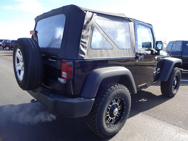

Old Jan 26, 2016 | 06:50 AM
warpeg's Avatar
Posts: 261
From: Ohio
It doesn't appear to have any mods, other than aftermarket rims and tires. Based on the spare tire, it looks like this one came with the 16" steelies and 225's. It looks like the other four tires are larger than stock....you will want to make sure that it has had speedometer recalibration.
