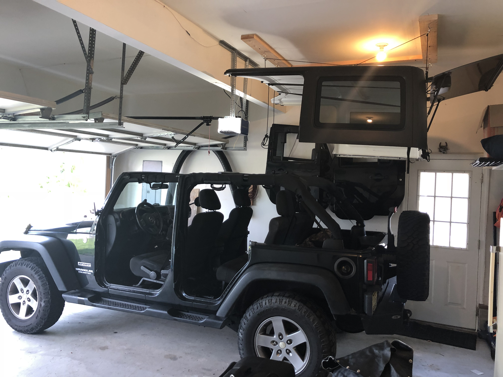

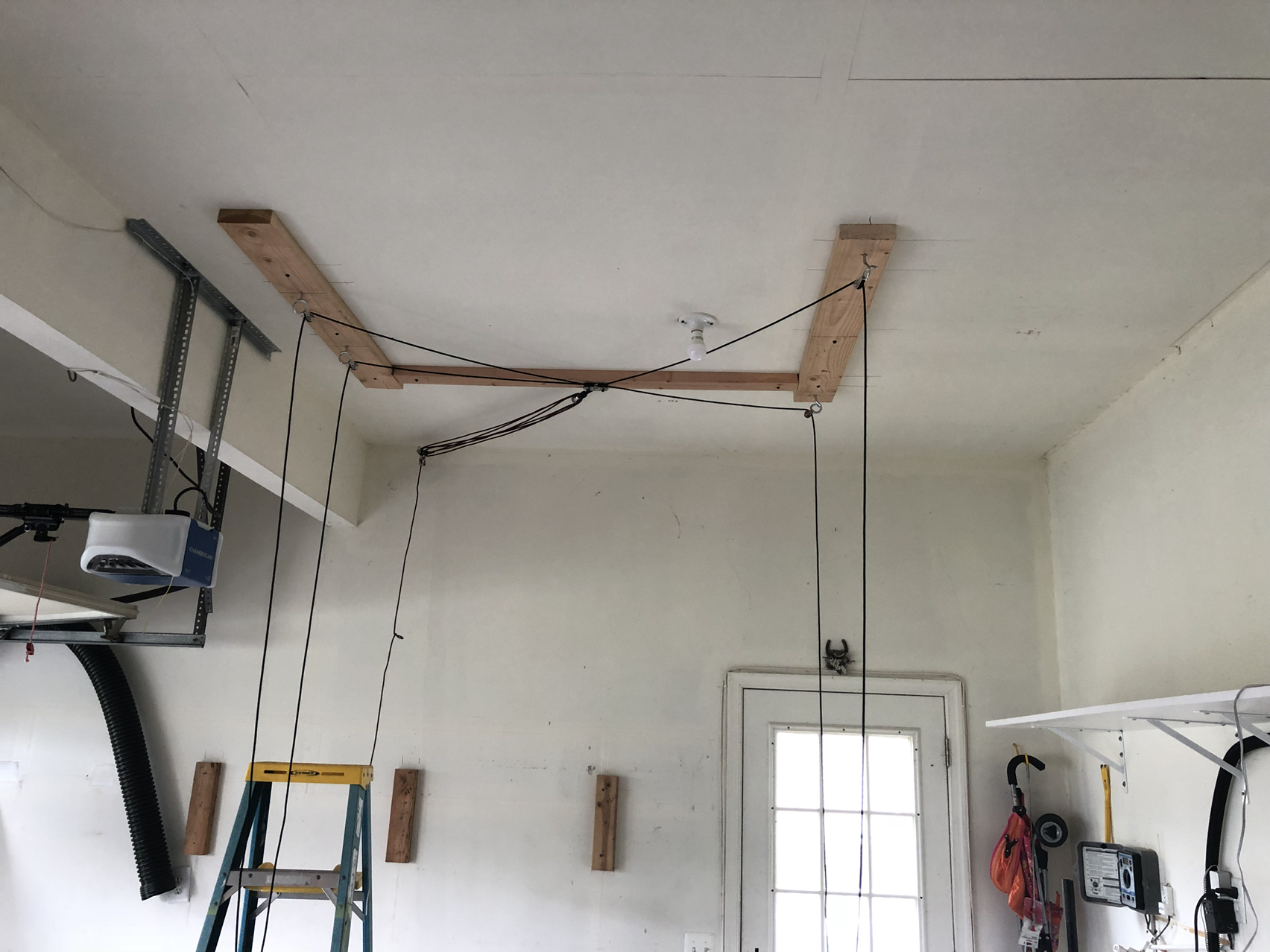

After 6yrs I finally took the top and doors off my Jeep. I installed the Harken hoist and it works exactly as advertised. Wow, it sure was difficult to get my doors off. I'll be looking for a good solution before putting them back on to prevent that seizing.
