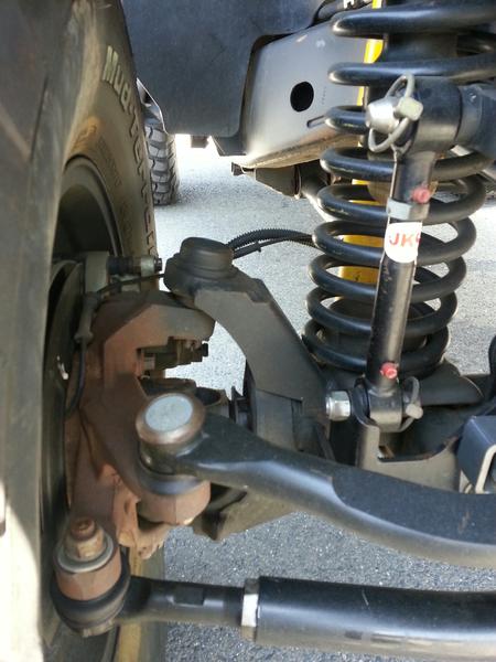

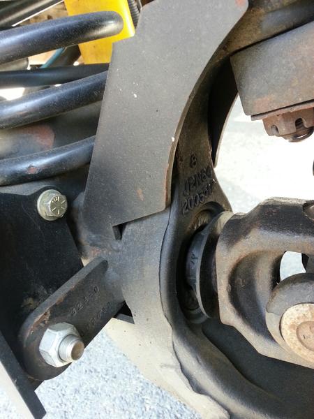

@XTZach
@XTZach i attached to pictures to my previous reply... are those the gussets and sleeves on the front axle? from what ive read on this forum, it seems like em....
