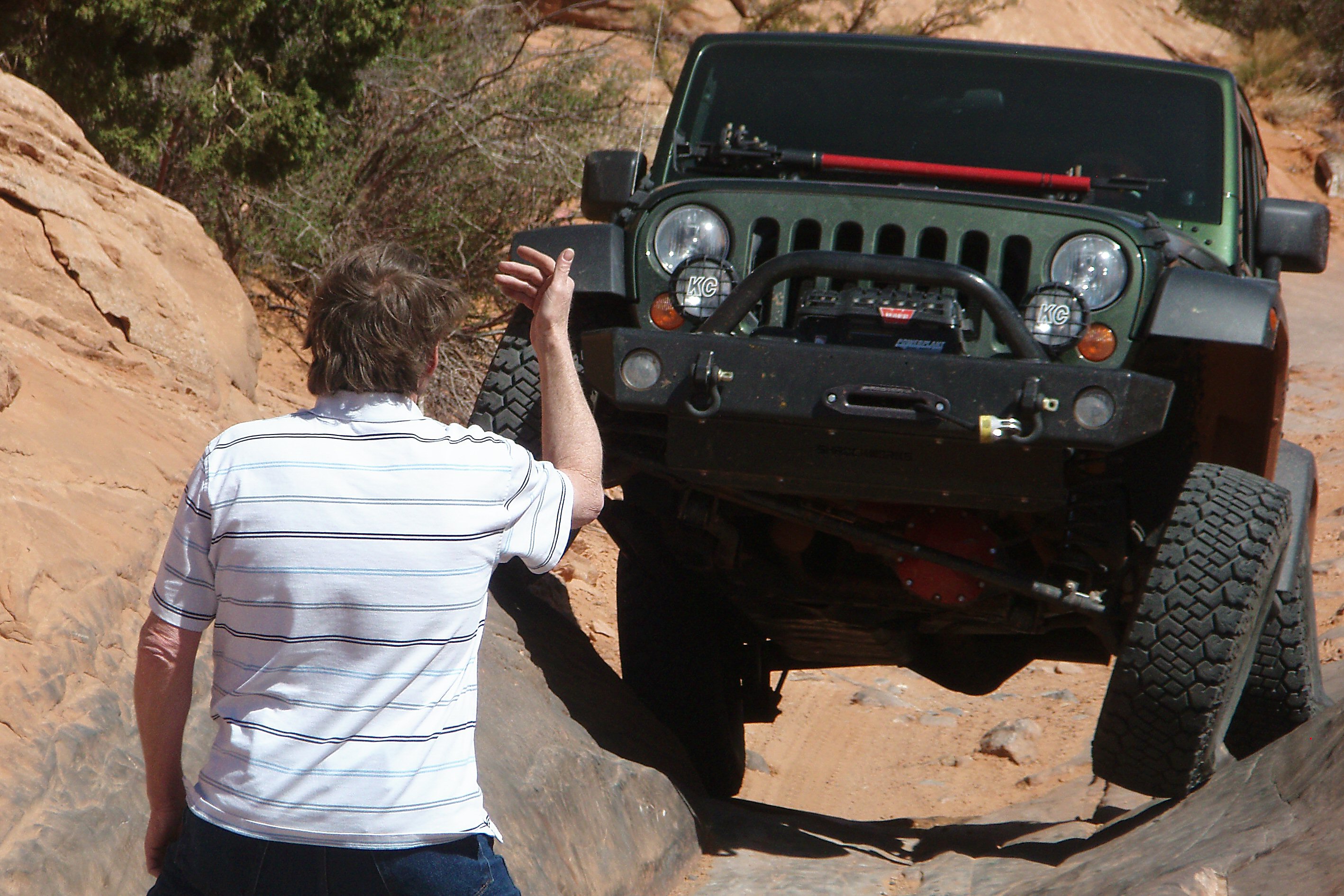

My Jeep years ago, when I had 2.5" spacer lift with 4.5" BS wheels and 33" tires ...

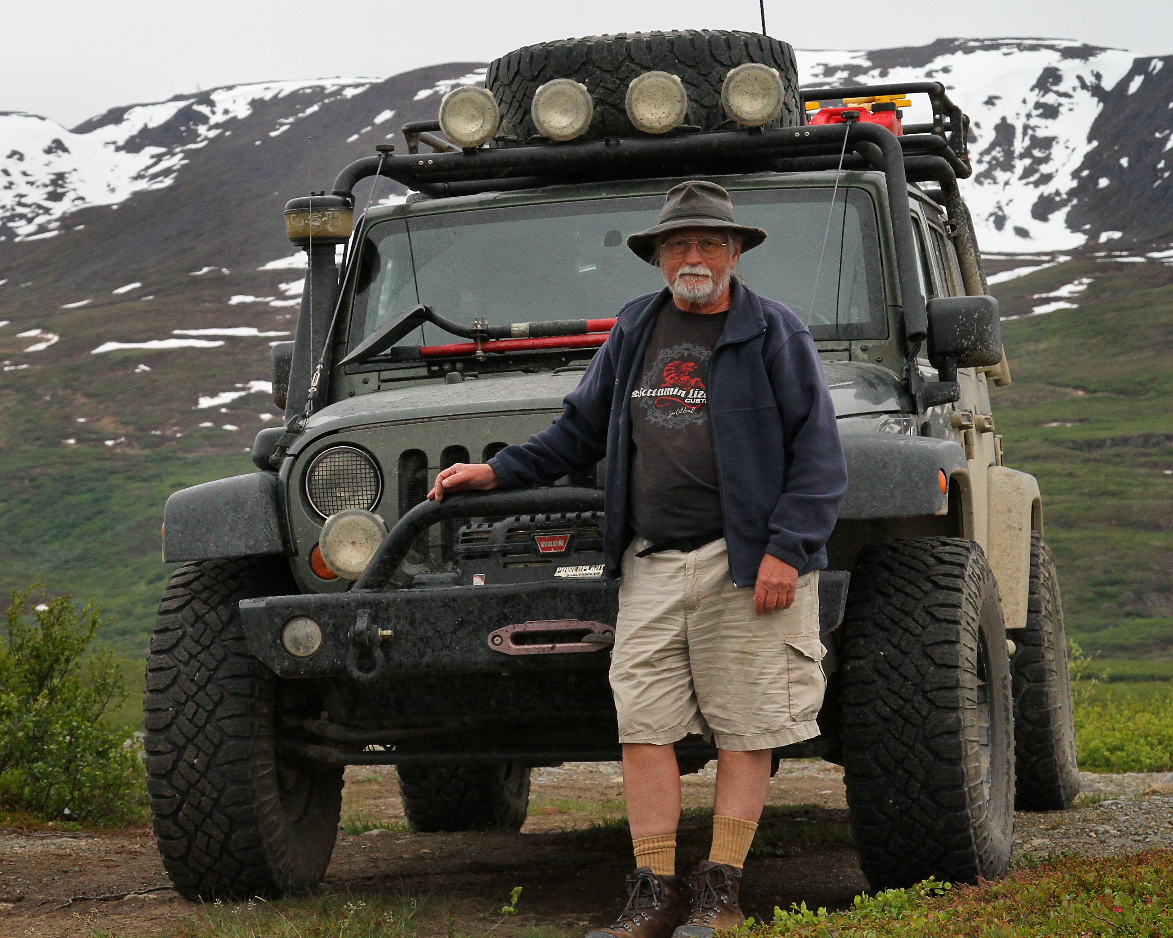

And my Jeep these days, 2.5" coil lift, same wheels, 35" tires ...
