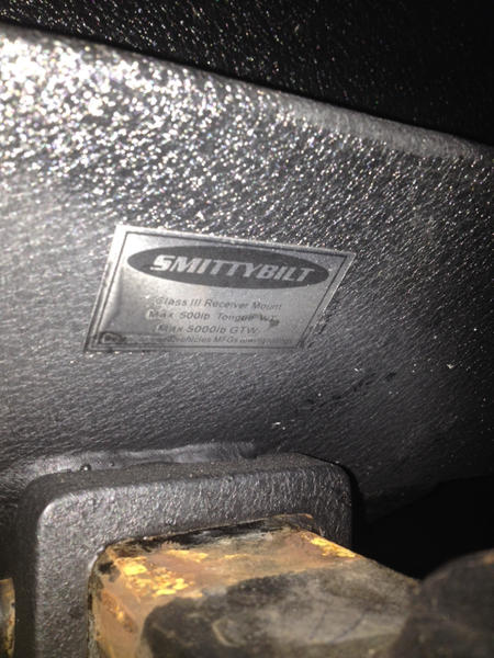

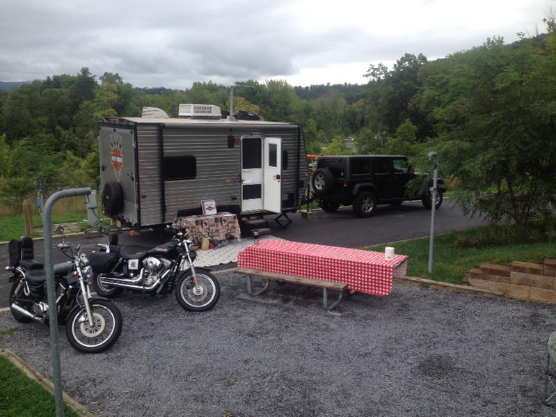

Check out my picture. I tow a toyhauler shaped like a box, weighing in at about 5000 pounds. I've put almost 6000 miles of towing over the past 2.5 yrs. I recently upgraded the rear bumper to the smittybilt XRC which increases the receiver rating to 5000 pounds. I love it. Just be safe. Electric brakes with controller are absolute must. I also use weight distribution hitch and friction sway control.
