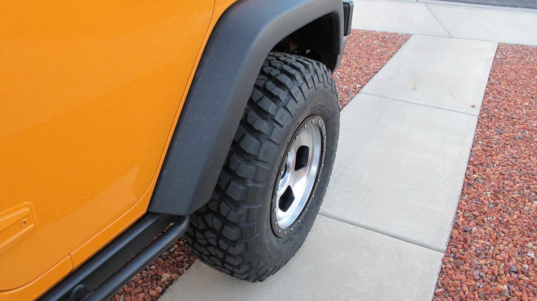

I have a 2012 JKUR with a Mopar 2" lift. I have the 285/75R17 BFG MT's on 17x9" wheels with 4.5" backspacing. And 4:10 gears, auto trans. I like your idea of 8.5" wheels (or even 8") with 5" back spacing. I don't do severe articulation but haven't had any rubbing issues. I don't like the tires sticking out about 2" beyond the flares. Don't like the look. Don't like the dirt slinging all over the side of the Jeep when I hit a puddle or dirt from a dirt road after the rain.

Thanks for the pics, nice rig. I'm still not certain how much lift I have but my tire clearance to the fenders seems similar to yours so at least I'm in the ballpark.
