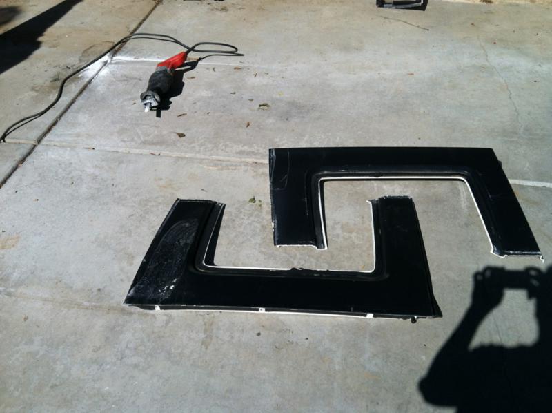

I won't take full credit for the idea, but I did add a twist to this. I bought a bestop bikini, windjammer, duster combo for those trips where I'd like to remove the top and enjoy the elements. Well as some of u know, the bikinis are such a pain in the butt to take off and on. I was so unhappy with the time involved in removal/install that I only used it once. I did however love the truck look while it was on. So I decided to try something that I've wanted to do for a while. Enjoy the pics and I'll keep posting pics as I get more done.
DAY 1

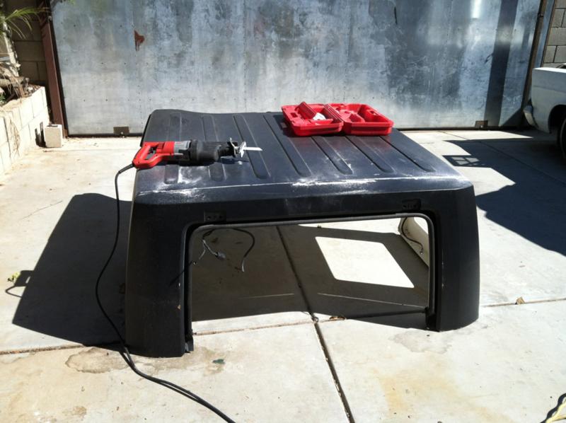

pull out the good ol' sawzall for the donor top I bought from a list belonging to CRAIG.

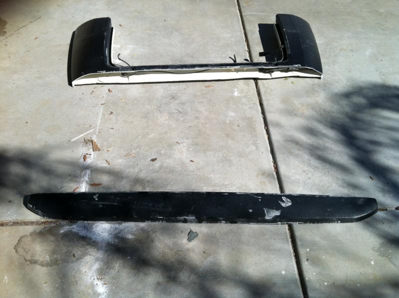

Then I began with removing the window frame area

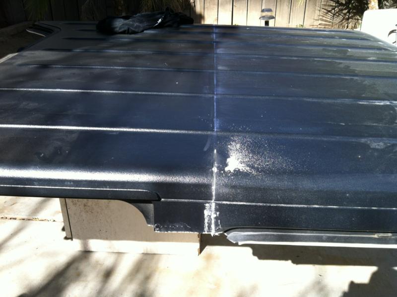

Then I chalk lined and began to cut more parts

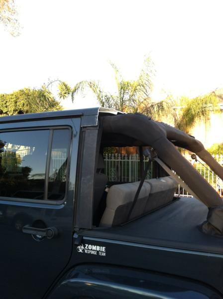

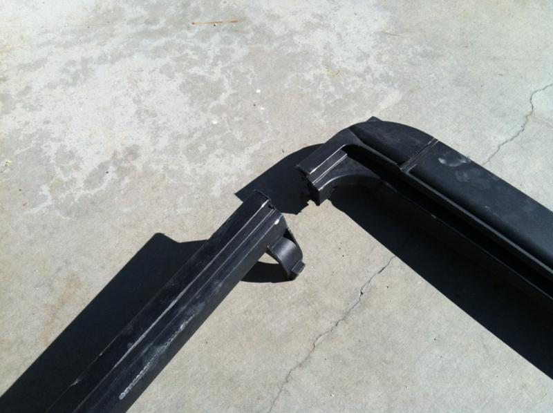

So many of u have seen this before ... Here's the twist I added.. I cut the pillar and used donor door surrounds so it folds for easy storage

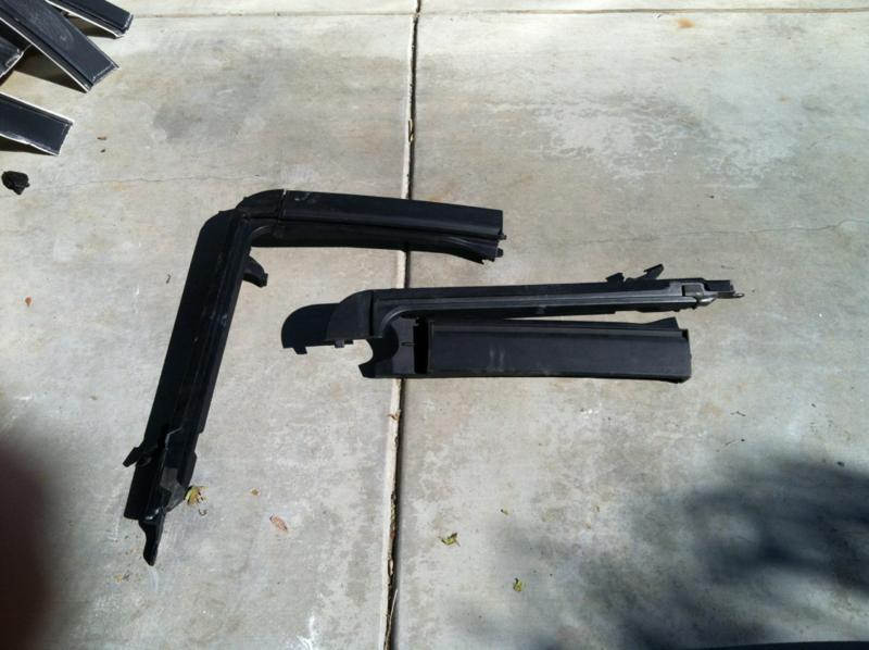

Had to cut and trim
