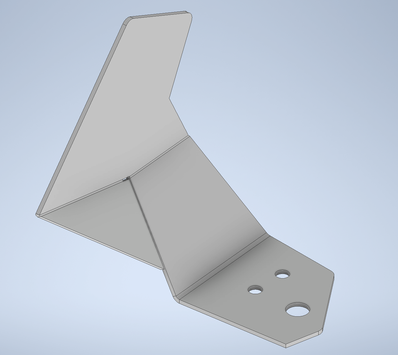

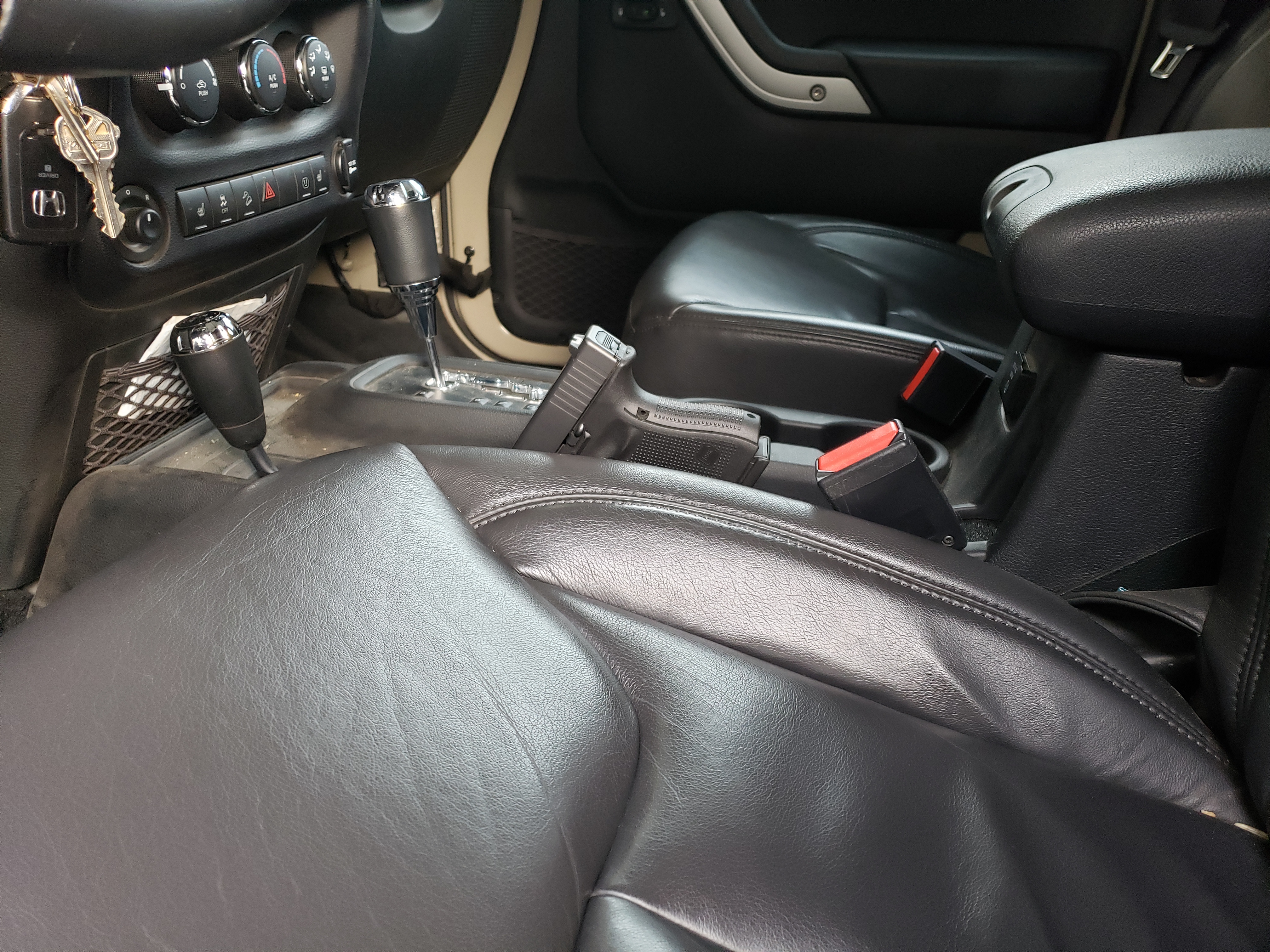

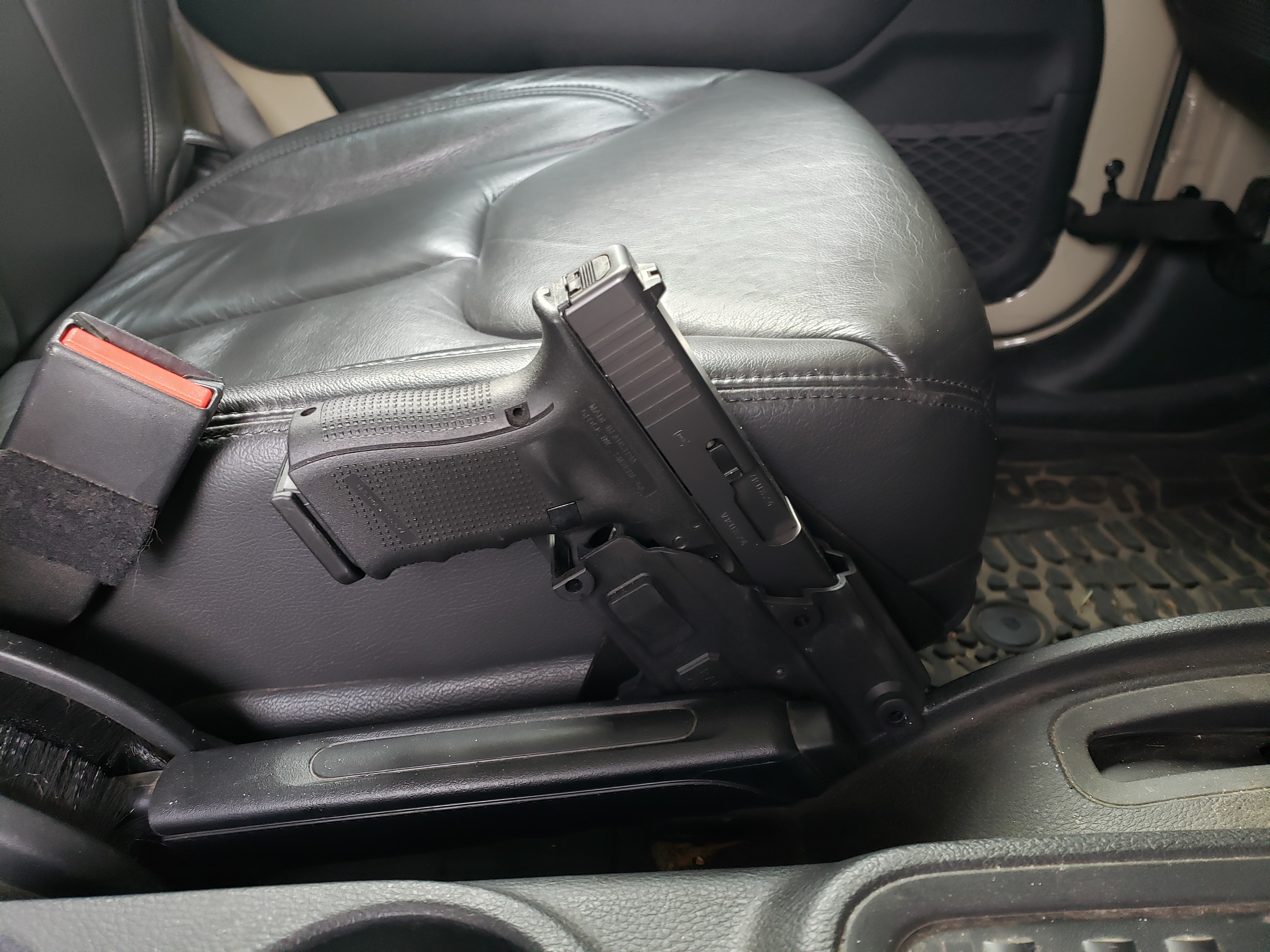

I decided to make my own custom pistol mount for my JK.
I designed the mount to hold the gun next to the drivers seat and mount to the under side of the seat base. I uses one stud that's already there and adds a large bolt through an existing hole and another hole in the rail that I added a button head allen bolt.

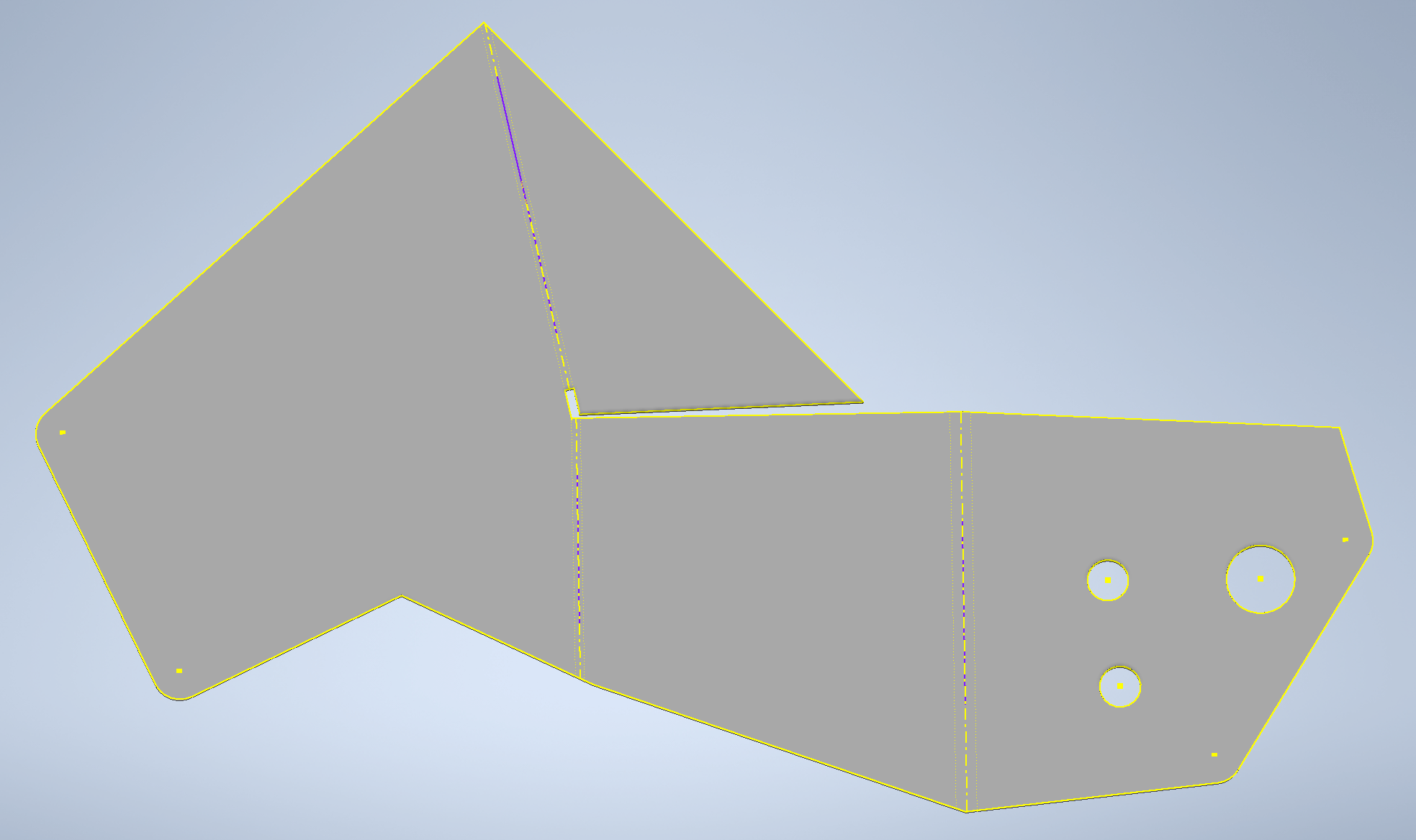

Flat pattern

I went with a USA Raptor Glock holster because it holds the gun securely so it doesn't fall out on the trial but also is lockable and easily accessible.

Wasn't really planning on it. I can provide a DXF file (if I can figure out how to attach that type of file) or I'm working on a PDF so you can print it, cut it out, trace the outline and hole centers on steel and cut it out with an angle grinder, then weld.
