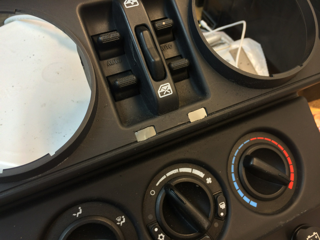

Now that you have that done you can go about drilling the center stack faceplate. Drill a small hole the width of the MALE end of the USB plug. You want the male end to fit inside the holes you make and the female end will sit behind the dash, this will hide the color of whatever outer jacket the extension USB cable uses and when it's plugged in there is a perfect amount of width left for the center stack faceplate thickness to not get in the way, I kind of suck at explaining it so hopefully the pictures help. Using a square file will help a ton to make them just the right size

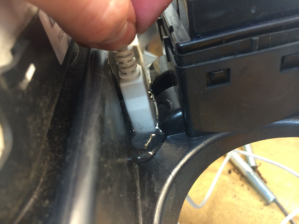

Now place your USB extension cable behind the dash and find a USB cable you want to use and make sure they fit together perfectly in the dash before you epoxy anything in place
Now WITH the cable attached at the front, and the extension cable at the back, mix up your epoxy and get ready to mount the extension cable. The reason you want the USB cable in the front while doing this process is so it doesn't drift as you hold it in place, this will prevent you from accidentally mounting the USB extension cable on the back in a spot where you can't plug your cable in. As long as your USB female side of the extension cable is flush with the connector (by cutting off the jacket like I mentioned before) you shouldn't have any problem with epoxy leaking through the holes you made and blocking your USB port or sealing the usb cable to the port. Make sure you hold it there for about 5 minutes while the epoxy sets.

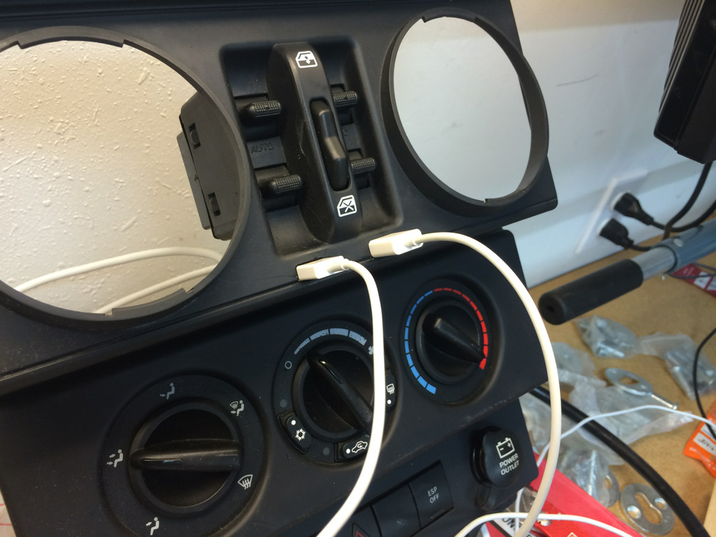

When all is said and done this is how it should look. Remember how I said you don't want to mount the female cable flush with the face of the center stack? That's because on a male cable there is a length of connector that sticks out of the female end, it doesn't fully "accept" a male end connector all the way. as such the thickness of the center stack plastic faceplate takes up this extra length and your cables mount very flush with the front faceplate when plugged in, and the female connectors end up being recessed.

After that you're good to put your dash back together and then you'll end up with this
