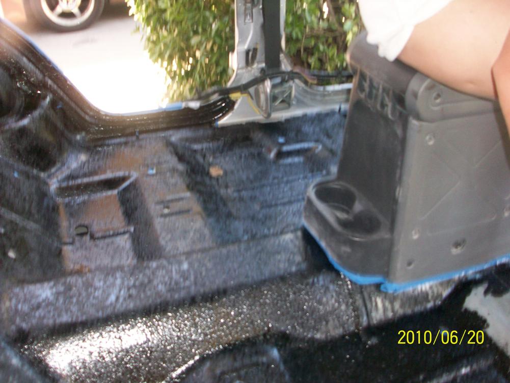

ok i did this tom my whole tub this weekend. and do i have some hints.
what not to do:
-dont put herculiner in a plastic cup. it eats it and it will melt.
-dont use the roller in the kit. it doesnt coat very well.
What to ensure you do:
-cover all bolt holes and tape what you dont want painted.
-Buy 4 paint brushes 2'' wide. if you have 2 of you are doing it. if not youll need 3 paint brushes
-buy some acetone from walmart. youll need it to clean up and it will remove the herculiner from your jeeps outer body.
-rough everything you plan to put this stuff on, the herculiner will run and not coat if it isnt rough.
now i want to thank my wife for the help. without her i would have been doing this all day. but 2 hours for the first coat and 1.5 hours for the second coat with her help. here are the photos.
Everyone tells me it looks like i had it sprayed in at rhino linings or line-x. so i am pleased with the outome.
