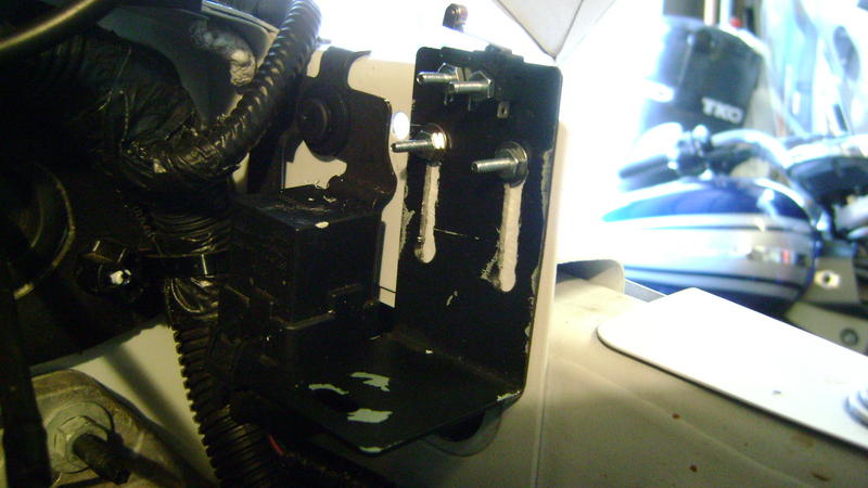

after the notches are complete hold the bracket and mark and drill mount holes for bracket. place at its lowest setting. finger tighten nuts.
Old May 6, 2012 | 01:52 PM
Gowheelin's Avatar
Posts: 57
From: Lacey wa.
Default Hood light cont...
Name:	jeep hood light 022.jpg
solder pig tails on to relay and the mount to bracket. I ran out of lockwashers so dabbed a bit of thread lock on those screws.

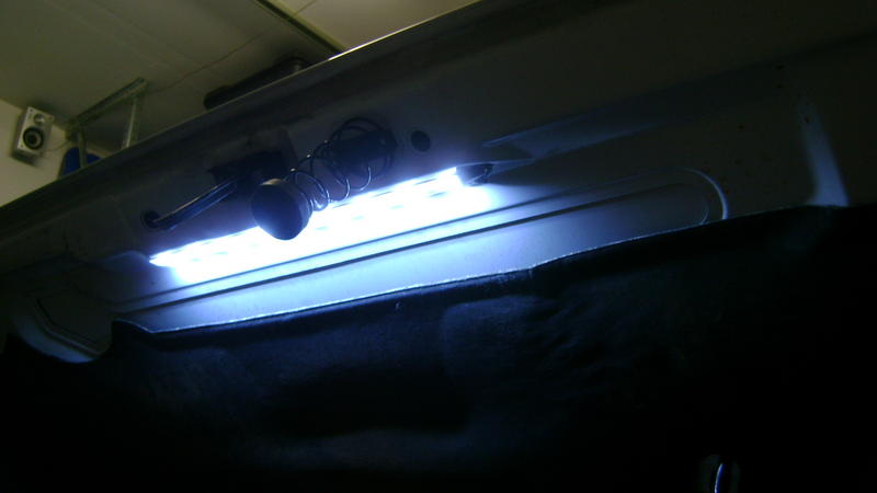

during day with switch off.....
Name:	jeep hood light 027.jpg
duringday switched on....
went out at night when it really matters. nice and bright. shines downward into the engine bay with good spread. and doesnt shine in the eyes at all
