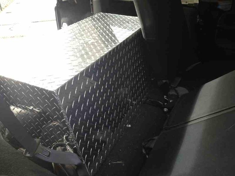

Here is what I have. It fits between the wheel wells, and still allows me to access the in floor storage cubby. The back side of the box is tapered to match the contour of the rear seats. Attachment 417340
