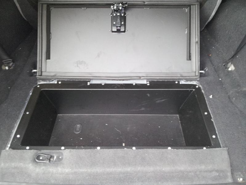

I installed the warrior lockable trunk today. Not hard as long as you don't mind cutting your old storage compartment out. Hardest part was trimming the old cover to cover the jack compartment. I know some people have managed to use the cover over the new box but I couldn't make it work.

Looks nice. I'm going to have to look into one of those. What tool did you use to cut out the floor & trip the lid?
I bought a cheap body saw from harbor freight ($39) but the directions say jig saw and a drill.

From: Memphis,TN
is it a significant amount larger than to old storage space?
Its a lot bigger... plus its more of a square so things fit better.
