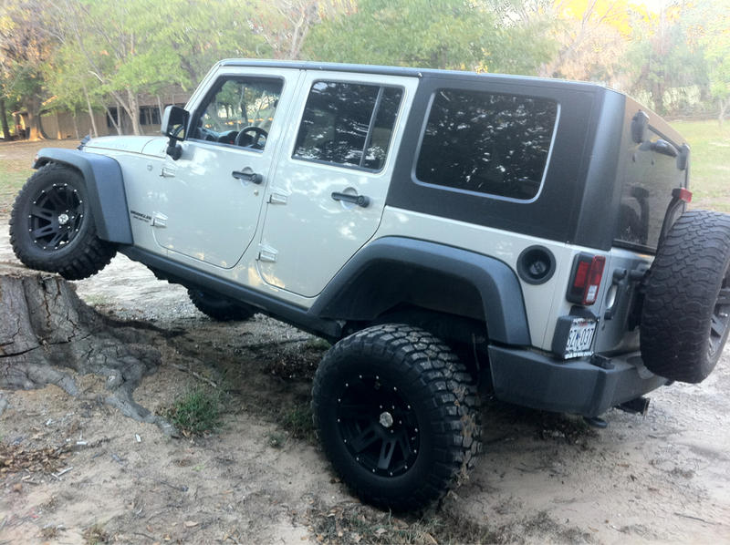

Originally Posted by Kojack
Yep. I ran my Cooper st Maxx with no lift and they measure a true 33". But they rubbed at almost full lock and when some flexing situations.
Here is the type of flexing where they will rub. Without trimming or increased bump stops.
<img src="https://www.jk-forum.com/forums/attachment.php?attachmentid=461030"/>
Sent from some string and a few tin cans.
You have excellent taste in wheels ! looking good!
