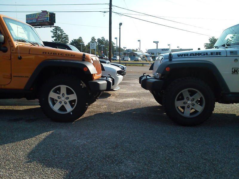

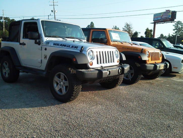

Old 05-08-2018, 05:16 AM
catahoula's Avatar
Location: Oregon
Posts: 2,998
Next to stock Rubicon 2 dr
Next to stock Sport 2 dr
