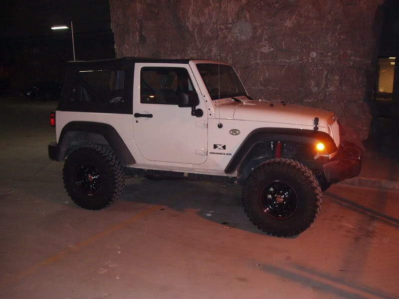

Thanks i like the 15s look.... to my buddy has 17s, pic posted below, they look good.... but make the 35s looks small, but hey thats not the look i like, hey that is why we are all different.

This is my jeep with 15' wheels along with Mickey Thompson Baja MTZ 33x12.50x15 tires. The wheels are Pacers, 15x8 with -13mm offset which is just slightly under 4 inches of backspacing. They work great and I did not have any grinding to install them.

Ok, I ordered the Tires in Dec 07, the wheels in Jan 08, and now I am home on leave, I got them married together. I was worried the 15" Crager Soft 8's would catch on the roaters, I even bought a grinder to fix this. I eased them on and WHAM, no grind, no rub, very happy TEXASREDROCK

With 15's, you need to run 3.75" backspacing to keep away from the caliper. If you are looking into them, I will give you all five of my 15" wheels nad 33x12.5 BFT AT's for 75 bucks each...only 6000 miles on them. Seriously, I will, I'm going with bigget tires/wheels, and I don't want these practically new tires I have now lying around my house.
But yeah, I run 15" wheels but with 3.75" backspacing. They're black D window Rock Crawler series. So the JK can fit them, you just need the proper backspacing.
