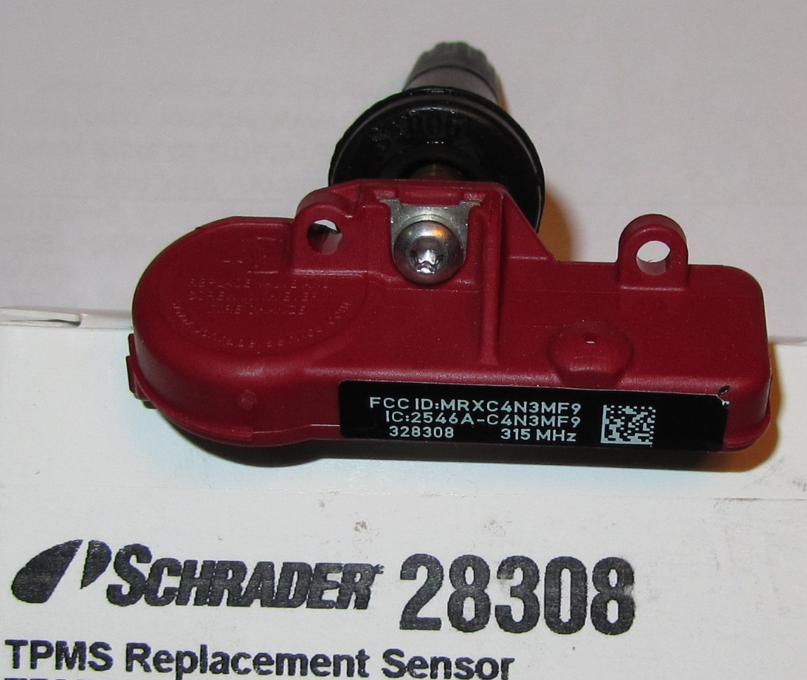

I bought 5 Schrader rubber stemmed sensors for my 2008 JK from Amazon for about $195.
Name:	Schrader 28308 TPMS Sensor.jpg
Attachment 675555
No problems? How long have you had them on?
No Problems. Had them on for 3.5 years.
