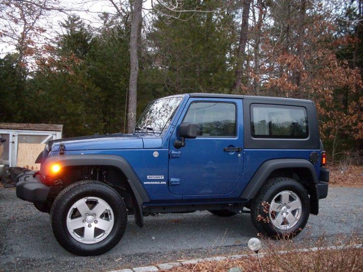

Would this tire fit on my stock sahara? According to the specs it shouldn't be any taller then stock but will be a little wider. 32.1" overall diameter on 8" measured rim, rim width range 7.5" to 9". Tread width 9". Thanks.
Originally Posted by blue project
I do have a leveling kit on the jeep in this pic but yes they will fit. About stock height just a little wider. No rubbing, no issues!
<img src="https://www.jk-forum.com/forums/attachment.php?attachmentid=374624"/>
Originally Posted by Cordur
I have those on mine. You need spacers to fit them at full turn or they will rub on the sway bar. Not a bit deal if they do but just keep in mind that they will. Mine only rubbed on the drivers side on a full right turn.
