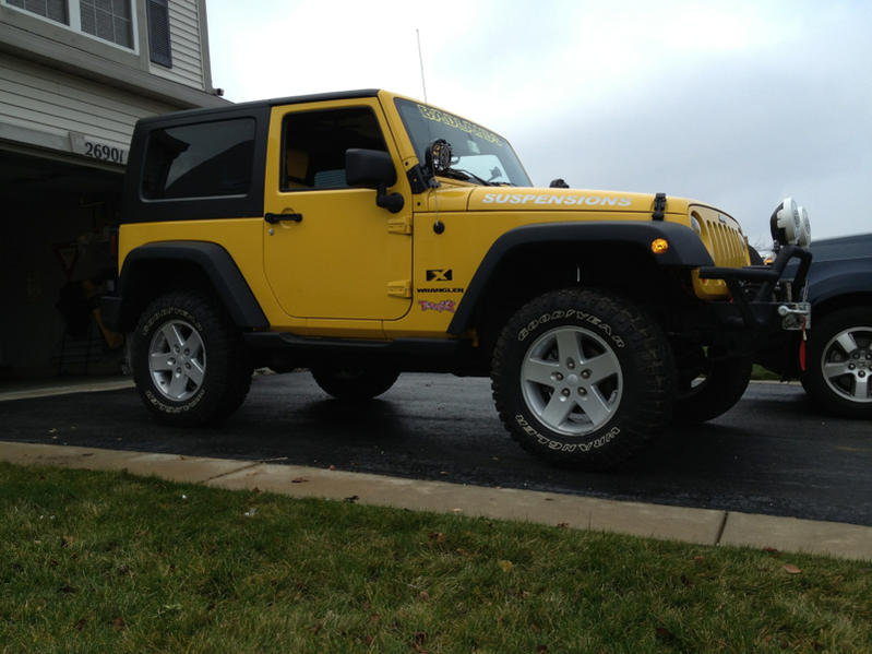

I'm right there with you! I bought duratracs 265 70 17 before my 2.5 teraflex spring lift and now they are too small an i am regretting it! Not so much the duratracs, but the size. I am thinking about selling these tires and getting the sizes you referenced. If I do I will really struggle between duratracs and MTR.
Duratrac is a great tire. So is the MTR. How did you decide on MTR? Please please post pics when done so I can make my choice also.

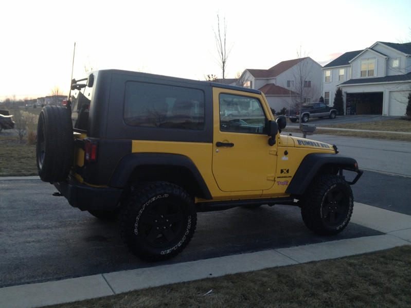

I just went thought this also.. I wanted a tire close to a 34" from the discount tire calculator here is the difference in the two sizes I was looking at.. keeping with a 17" rim.
I ended up buying the Toyo MT's 285/75/17 and should be getting them Friday.

Thanks for the input everyone. My measurements came from online tire conversion programs that convert metric to standard sizes. I have no first hand knowledge of actual heights. I struggled between the duratrac and mtr, but settled on mtr because I'm looking to get the best traction offroad. It is my daily drier, but when I offroad, I count on my nearly stock (in the suspension department) rubicon to get the job done. I've got a set of wheels and tires off a Sahara that I bought cheep. I use them for long road trips.
Keep your thoughts commit everyone! Unfortunately, it looks like the mtr only comes on the 305 size, which may be to wide. I have no way of knowing.
I'm guessing the actual measurements from tire to tire and manufacturer to manufacturer vary. You best to measure the tires you want in person. Looks like a pretty different actual
Measurement from
TOYO to GY.
Measurement from
TOYO to GY.
My Toyo AT2s that are 285/75/17 measure 33.1" don't trust manufactures numbers they are rarely accurate. Ask forum members to get real world measurements. I have 1.5" wheel spacers and a leveling kit. No problems. Wish I went with 35s though. Good Luck.
