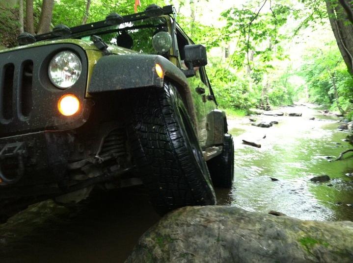

Originally Posted by Deester157
Any suggestions to what size lift I need to run with 33"s? Any advise on lift? Thanks
I've been running 33's on a stock suspension and Procomps w/ 4.5 back spacing and I will tell you. You will rub off road. Been there done that. I have since trimmed my fenders and have a 2.5 lift coming as we speak. Daily driving was absolutely not a problem. Never had an issue, the only contact that was made was the tire hit the outside edge of the flares. No damage to speak of, just sounds horrible...LOL!

Stock
33's stock tires
33's w/ ProComps
Stuffed
