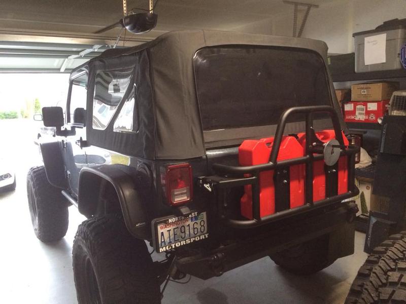

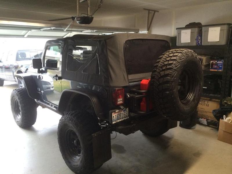

[QUOTE=itsthelaw;3853644]I want to keep my back seat and forum consensus says I need a spare. To pay $700+ to keep from tearing off my tailgate seems pretty excessive, Yes...I know a tailgate repair would be more expensive! What is everyone using and what was the cost? My only requirement is that it swings WITH the tailgate. I don't want to open 2 things just to get my dog into the back. Oh, yeah...it also needs to be less expensive and sturdy. I have a 2013 2dr.[/QUOTE
Take a look at this: Smittybilt Oversized Tire Carrier in Black, For 07-14 Jeep® Wrangler & Wrangler Unlimited JK, Quadratec Part No: 22202.2001, Manufacturer Part No: 2743, $129.99, Attaches to the factory tailgate using the existing holes and requires no drilling or modifications. Completely adjustable and designed to mount up to a 37" tire or up to 195 lbs. Hope this helps...

is it me or does that smitty carrier look like its gonna have the same kinda problems as a stock carrier still looks like its gonna rape a tailgate first bump you rock
