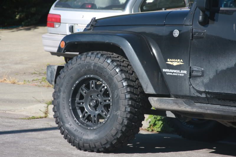

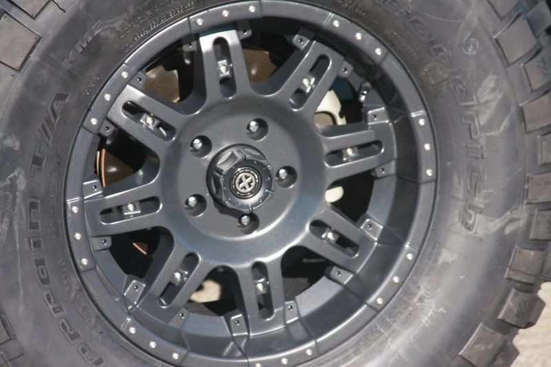

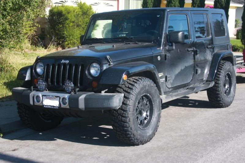

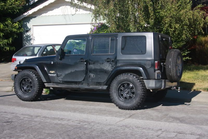

just installed my 35s on my stock sahara....OMG ! I love it !!!!!
pics soon
rolly Aug 1, 2009 05:03 PM
http://i147.photobucket.com/albums/r...a/IMG_8310.jpg
http://i147.photobucket.com/albums/r...a/IMG_8312.jpg
http://i147.photobucket.com/albums/r...a/IMG_8313.jpg
http://i147.photobucket.com/albums/r...a/IMG_8319.jpg
