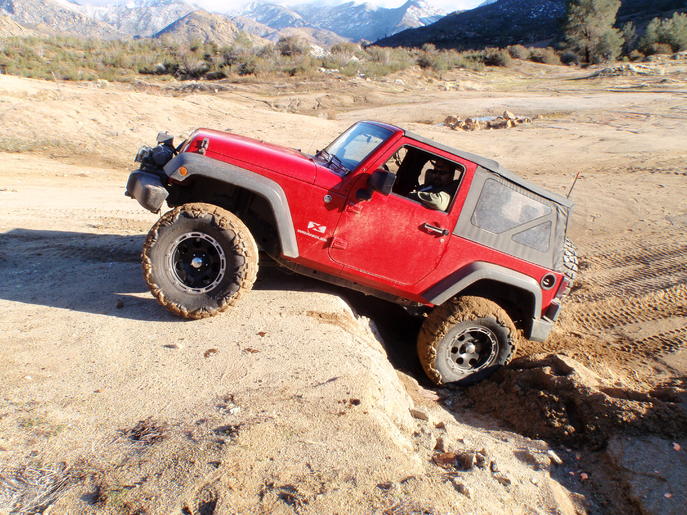

I have an X with 35-12.5-17 Mudd grapplers. At the moment i have 3.73 gears but will be getting 4.88 pretty soon. I like them, they are not too loud. I have a soft top so its got some noise anyways.I also have a 4in lift on it
