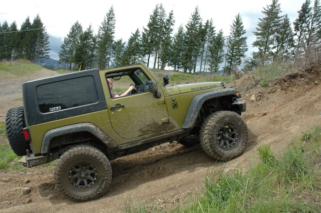

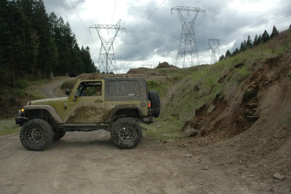

I'm running a 4" lift + 1.25" body lift...Yes you will get blown all over the damn place on the highway if there are 15mph gusts. It's scary as hell to drive in 35mph-55mph gusts in the Columbia gorge, but I do it. At times I can get blown 1/4-1/2 into another lane if I'm not constantly correcting. It's a PIA on those days
Here's how it looks>
Unless you play in the mud a lot I would rec. against lifting the Jeep that high. My COG blows in off-camber situations, but I'm usually in the mud holes or doing straight ascents/descents, be careful whipin' it in corners too. I'm pretty much required to drive like a grandma on road.
