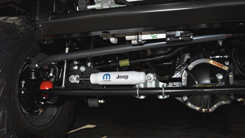

If you plan to lift it that much and want it to drive good on the road the top thing on your list after the lift is order a pro rock 44 unlimited so you can keep your caster up so your steering is not all over the road and yet your front pinion won’t be pointing at the ground. And when you order the pro rock have them put an attachment point for the track bar that allows you to move where it connects to the axle up high and do a drag link flip. I found all this out after I lifted the vehicle (also a 2012). Here are some examples of what mine looks like. I know its a lot of money but I wish someone had pointed this all out to me before I did the lift. I called 4x4 shops all over the country trying to figure out why the steering was so wacked and thankfully someone on here explained caster to me in great detail. He was right this took care of it. After the lift it drove like crap after this it drives better than new! Northridge did the track bar attachment for me before they shipped the axle to me!!
