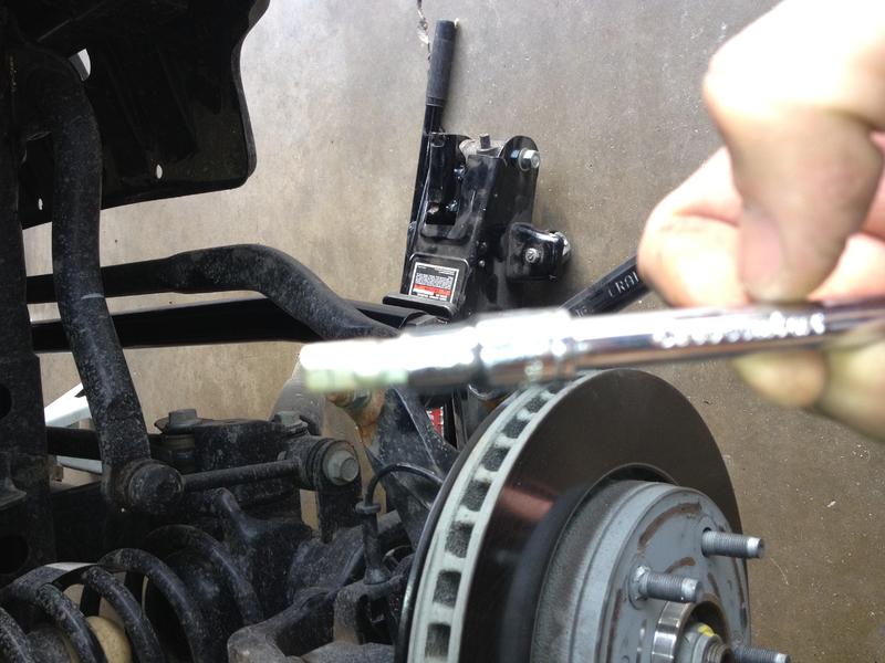

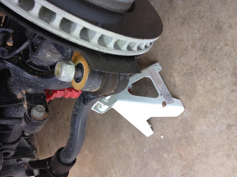

Drivers side. Only loosened just enough to get it off but not drop.

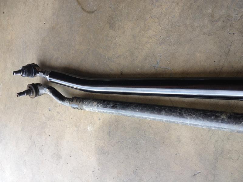

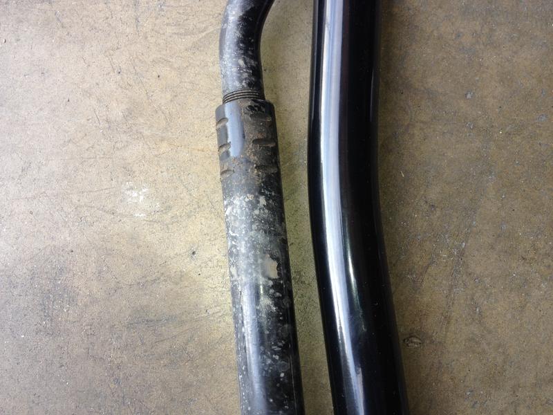

Aesthetically speaking, the RK tie rod is much more appealing to the eye. Not that this matters, but I like form and function haha
More Comparison.
As you can see, the RK looks a lot beefier.
The factory is all steel and is physically heavier than the RK tie rod.

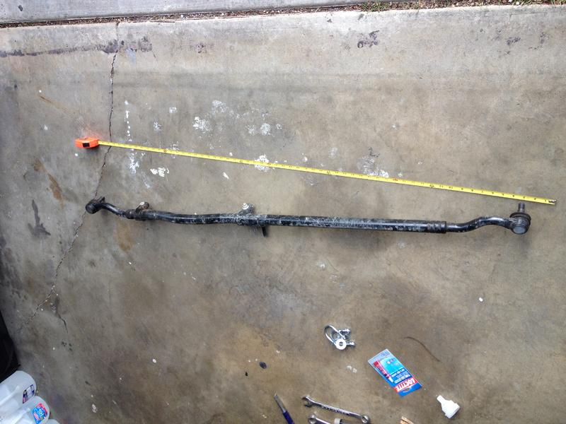

After measuring a few times from several different points i think i decided something like 58 5/8 on center. I took my time with this.

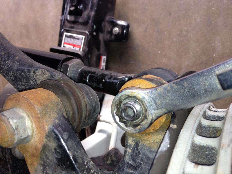

I was tightening down this bolt for the longest time before I realized it was just spinning in place.

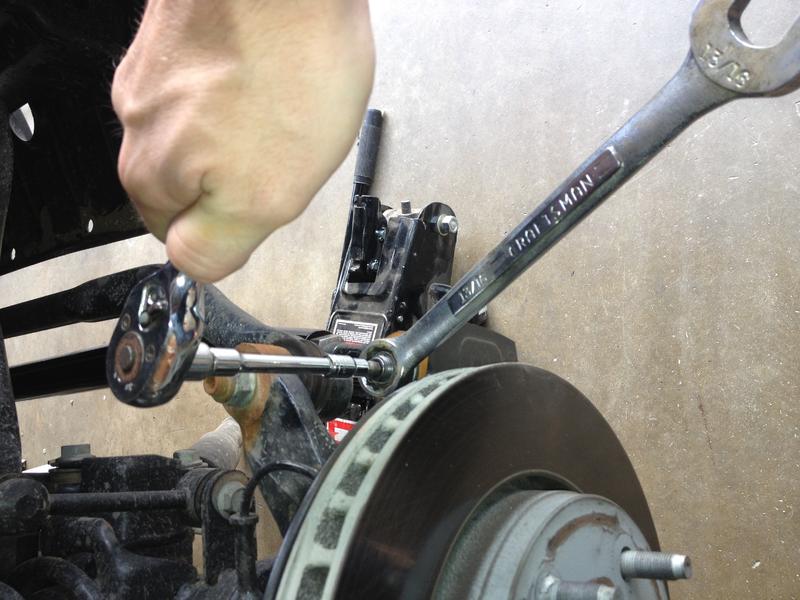

Couldnt find the appropriate size so had to hold the 18mm nut in place with I think it was an 13/16 wrench?
Then tightened it with a socket wrench and this allen head piece i had to finagle together with an adapter and an extender.

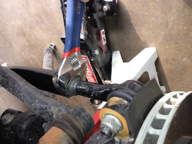

Giving the nuts a final tightening.
