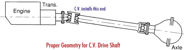

Go out to Tom Woods website, he has a bunch of info including a few pics of the angles you want. Stock driveshaft, pinion roughly parallel to the tcase output. Double cardan, pinion pointed at the tcase output (inline with the driveshaft). Up front, there is a compromise between caster and pinion.

yea ive read a bunch of those. seems like ideal is 0* but im trying to convince myself that mine is close enough to zero so i dont need to buy adjustable rear upper arms.

We have a JK with the almost identical set-up. We've used it primarily for testing our JK ProGrip brakes, but it has wheedled quite a bit. The CV's are very tolerant of angle deviation. I totally get the on-trail repairability of the old-school u-joints. The Tom Woods guidelines will have to be implemented if you go to the 1310 Dshafts. So plan on at least one set of adjustable control arms in the rear. I would consider the lowers, because you may be able to better set the axle position (a little back) to compensate for your lift, as well as the pinion angle.
