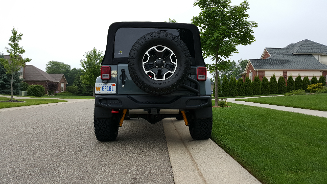

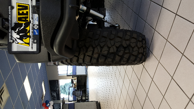

Your a little of on your figures.
Stock Wheel Backspace = 6.25
AEV Wheel Backspace = 5.20
I happened to want to get the same look as the AEV wheel under the flares, so I got rid of the 1.5 spacer in favor of the 1.25. It matches up fairly well to the AEV Pintler Wheel backspace with using your stock wheel.
First photo is my Jeep, second is an AEV Jeep.

That was my original figure, sorry. I also forgot the AEV were 8.5 instead of 9.
