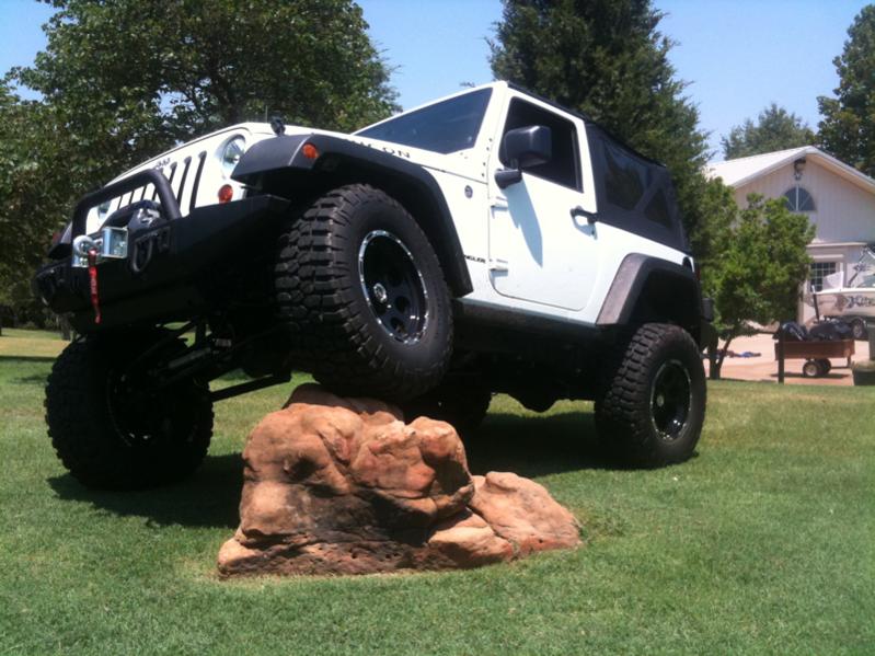

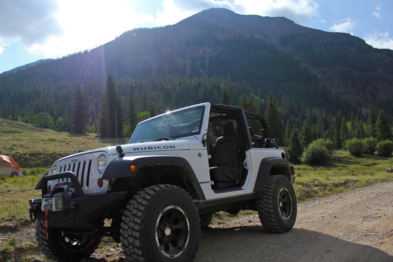

We put a 3.5" AEV Premium on our 2dr 6 speed in January and a new rear Currie driveshaft with Teraflex rear upper and lower control arms in early July. Rides phenomenally and had no problems before the new driveshaft. Just wanted to be safe. Just drove it 1500 miles to Colorado and back with zero problems and spent a week up there taking it on moderately difficult mountain passes with no problems as well. Couldn't be happier.

Did you use the drop brackets with the front lower control arms? Did you change your caster from what the aev kit sets it to?

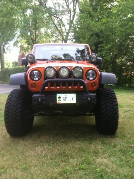

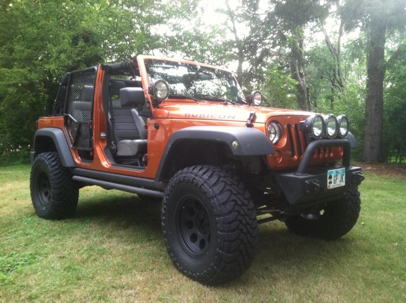

Finished up awhile back, but the tires were delayed. I wanted to wait and post when everything was done. 4.5" w/ 37" Toyos
