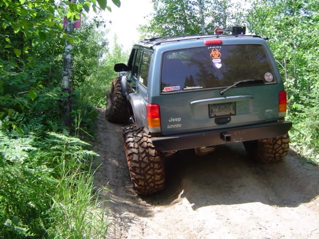

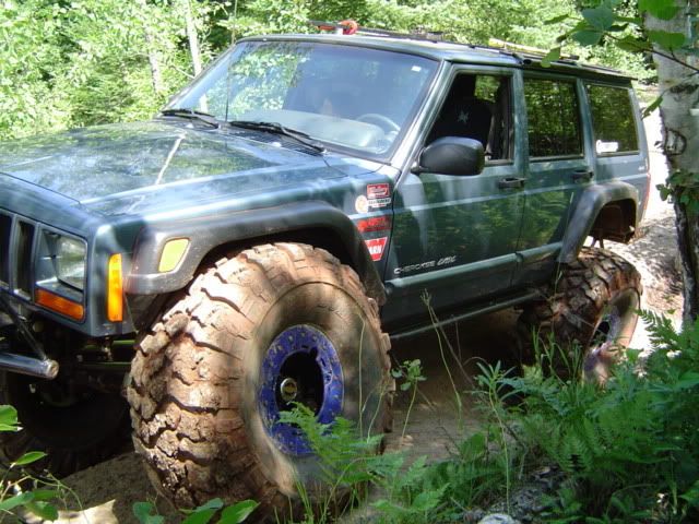

Originally Posted by 4LO
If you pay close attention to your trackbar and steering geometry, use quality adjustable shocks(MX6/RS9000), and build it right, you can get just as nice of a ride on coils. Also much more cost effective and less things to go wrong.
I know why you want AiRock. It's the same reasons I wanted it. It's neat, cool, blingy, soft, adjustable...
But I've built many street-friendly rock crawlers with up to 40" tires. If you build it right, you won't need to make adjustments other than locking in the sway bars and maybe dialing up the shocks.
This Jeep ended up with Dana 60's, 39.5" PittBulls, and went 80mph down the freeway with NO steering stabilizer! GEOMETRY is the key!!
Thanks for the input. It's especially valuable since it looks like you had put thought into it. I can't see the pix at work, but I'll check'em out tonight.
