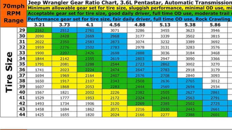

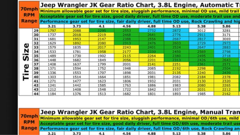

according to the chart, there doesnt seem to be much of a difference. ive been running 3.21 gears and 35's for roughly 10k miles since i moved back here to Pittsburgh. the 3.21's arent all that bad, but nowhere great either. i get roughly 15-16 mpg on highway but despite all the negative comments on the forum from other members i didnt really think they were all that bad but i just ordered yukon 4.56 gears to install in the next week or so.
