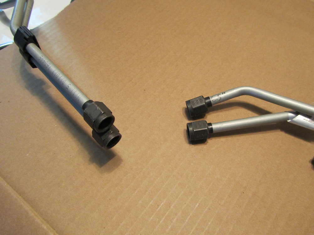

This is what I'm doing to my OEM lines. I have the parts for the flexible portion, but haven't needed to put it together, yet.
By the way, when I purchased new OEM cooler lines for this project, they were only about $30.

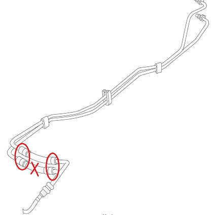

Line number 1 is the part and the leaks are near the factory crimp areas (circled). The line has a splice in it where the aftermarket cooler goes (x marks the spot).
I used a write up on this form, but just found another person that said the stock fittings will leak after a while.

I cut my steel lines and installed braided steel AN lines with compression fittings. Did this 3 years ago, no problems.
But a good transmission repair shop should be able to re-do the line no problem.
I just had another baby with my wife yesterday, so I might not get to the picture anytime soon.
But:Here is what I ordered from summit racing to do the repair. Make sure you cut the braided line perfectly. Tape it really well to keep it from fraying, and I found using an angle grinder to cut the braided hose gave it the cleanest cut. Here is what I ordered from Summit racing, but the lube was a waist, don't bother with that: Part Number Part Description QTY Tracking Number Carrier: Est. Arrival SUM-2200077B -6-3/8 MALE HARDTUBE FIT BLACK 2 UPS: 3-4 bus. days SUM-220690B -6 STRAIGHT BLACK HOSE END 2 UPS: 3-4 bus. days EAR-184004ERL ASSEMBLY LUBE 1 UPS: 3-4 bus. days SUM-G1001 18 INCH AUTO FLEX #6 HOSE 1
