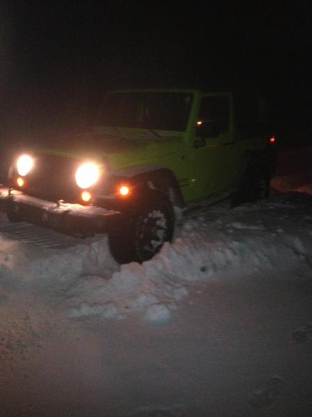

Kay some some of you may have read my thread i posted earlier today about wanting to mod and my inclination that my JK would get blown out of the water by my buddies' CJs and YJs. On the way hime from the gym i took a ride around the yard in a out 1.5-2 fee if snow just to blow of some steam and document my issues with my jeep. Go ahead and tell me i cant drive and why im wrong. Take into mind i was in 4high, have 3.21 gears and 275/70/17 tires. No mods otherwise. Personally i think i should have been able to get through this junk in 2wd slowly rollin, i knowwwww my comrades CJs and such would have (granted they have circa 2 inches of lift and mud terrains) here i am stuck a few minutes ago... And yes i was bottomed out. Is a lack of lift my biggest issue in this particular situation?

Looks like you dug yourself in being in 4 high with street tires in a couple inches of snow. Instead of staying in one place spinning your tires try backing up and keeping your momentum.

dug to maybe 2.5 feet. They are cooper all terrains haha. And yea pinned i woulda banged through the drift , but that wasnt the point. I just feel that i think i shoulda been able the stop in the middle of that, drink a beer and effortlessly roll on out haha. But anyway thanks for the read. And with enough back and fourths i got out under my own power.

If you look, in one of the pictures you can see the imprint from your plastic plate that is just under your bumper, that gives us a good idea how deep that snow was packed...
With good wet snow you can pack it so it lifts you up and your wheels can't help you

i used to be the same way. Mind set was oh I have a jeep I can go through anything. well, I learned real quick thats not the case. And I learned the hard way in snow. If its wet and 2' deep. Going fast will just dig you in a hole and once your diffs are buried or up to your frame, you aint going anywhere.
Also tires and lifts play a big roll. In deep snow like that a M/T tire is going to work wonders. A/Ts seem to do better in light snow. Unless you have duratracs since they have a deeper more aggressive pattern. Airing down is key too. A wider tread print is always better in snow. Also bigger tires mean your diff is higher off the ground and less prone to burring its self. Same with lift. If the snow doesnt reach the frame you have a good chance of making it.
