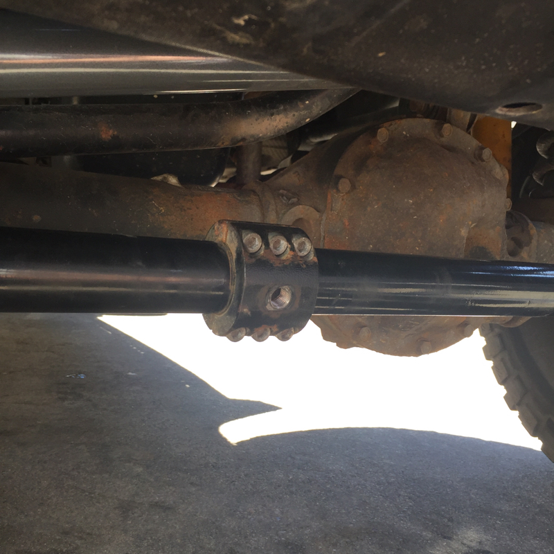

I told him the steering stabilizer could be my fault but the vehicle should drive straight. If it doesn't drive straight after the 3 time of you aligning it I'm going to need a refund. Right on the spot he told me he would give me a refund since I won't be a customer he could make happy.
And of course I get my vehicle back and now my ESP BAS light is on and traction control light is on. Right after he gave me another "free alignment."

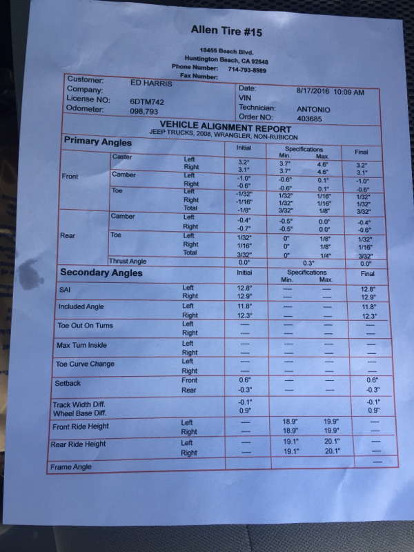

Here are my numbers. I'm waiting for a call back from corporate headquarters.

Old Aug 17, 2016 | 11:14 AM
karls10jk's Avatar
Posts: 5,642
Likes: 486
From: Knoxville
Check your lock to lock motion and see if maybe they over adjusted your steering wheel the reason your lights are all on. The wheel being slightly off center could cause...the traction control light....if I remember right.

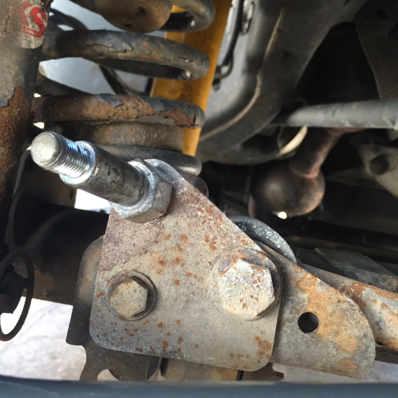

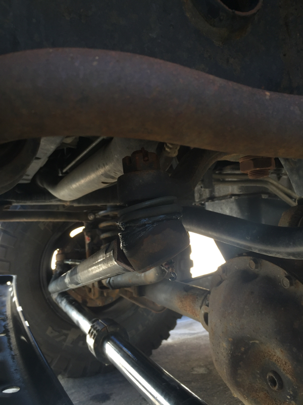

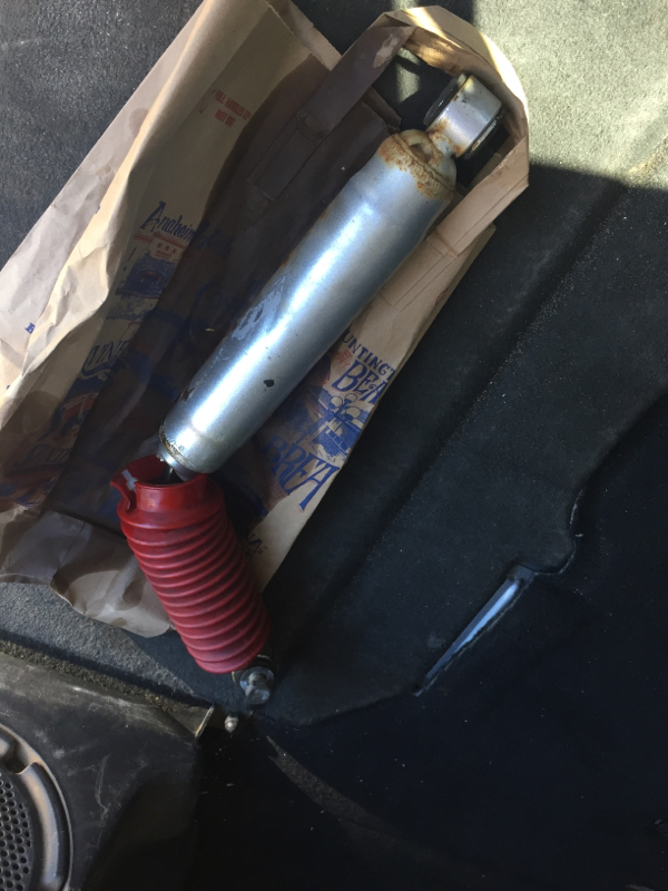

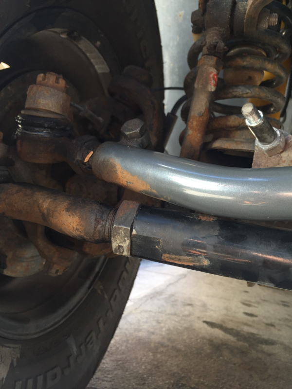

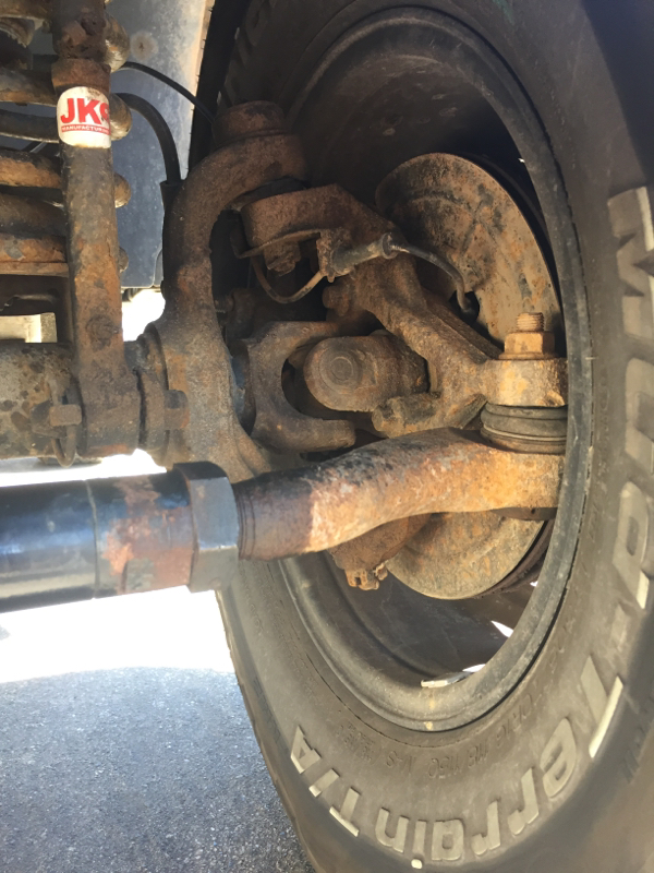

Here are some pictures. Maybe if someone sees something that stands out?
I think I may be dealing with some people who really don't know jeeps and modified suspensions. The first place is telling me that the relocation bracket was put on wrong and that the entire steering stabilizer should be lower in which I had to explain to them the purpose of a relocation bracket. Then I took it to a second place in the chain location about 8 miles away and they told me that the bend in the synergy drag link was not supposed to be there. The factory bend in the chrome alloy drag link made by synergy is not supposed to have that bend in it where it connects to the passenger side tie rod. The steering stabilizer must have bent the drag link!!!
Needless to say I pulled my vehicle immediately out of the second location also.
Old Aug 17, 2016 | 02:35 PM
karls10jk's Avatar
Posts: 5,642
Likes: 486
From: Knoxville
Is that where your steering wheel sits with the wheels pointing straight ahead?
I agree, you've found the original engineers from Chrysler who clearly know oh so much about suspension. I'm surprised they won't start moving things to see what happens with your numbers instead of crying wolf at a clear design note like a bent drag link.....maybe the other shop got the link and the stabilizer confused and put the bend into the stabilizer??
