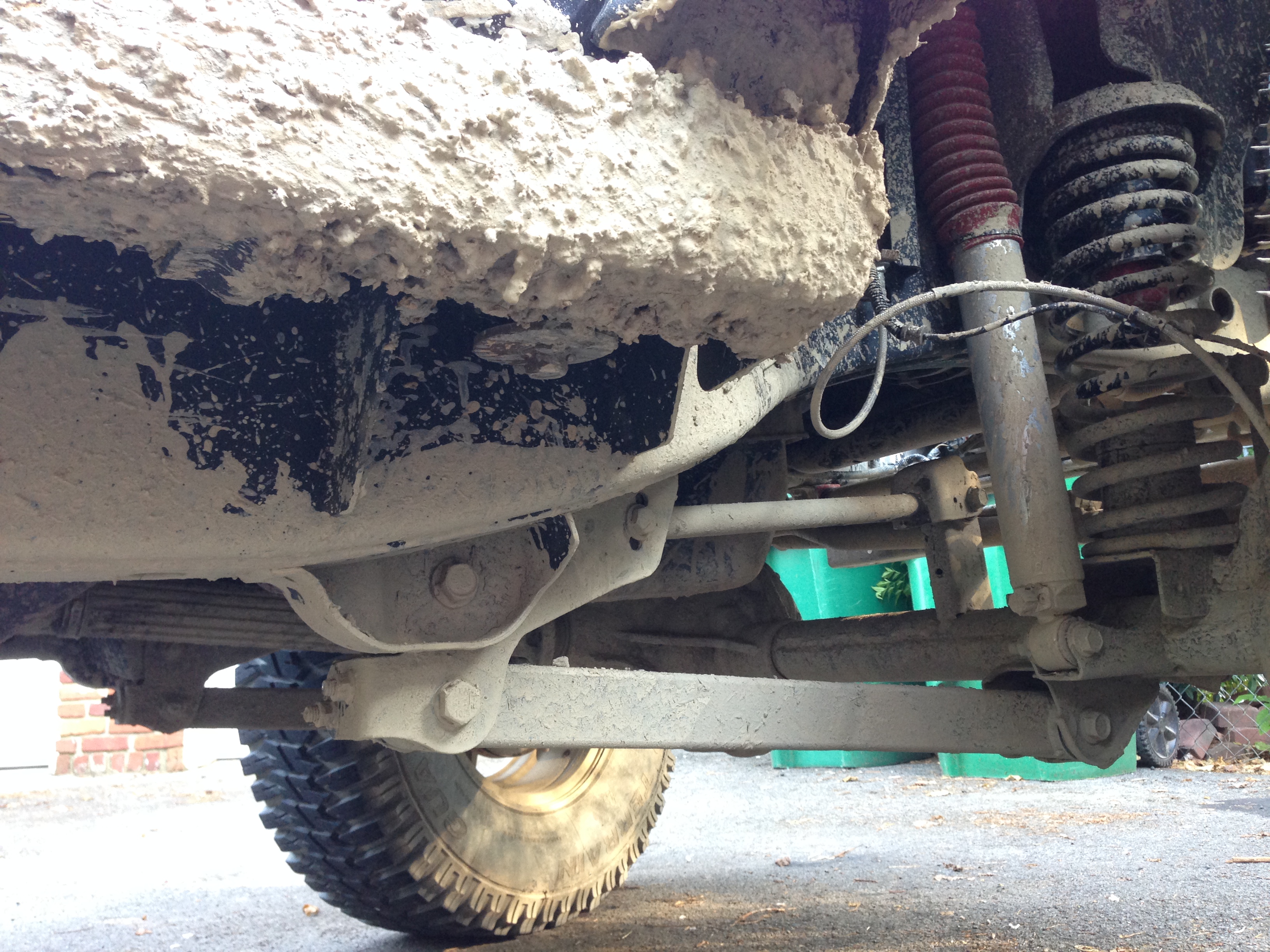

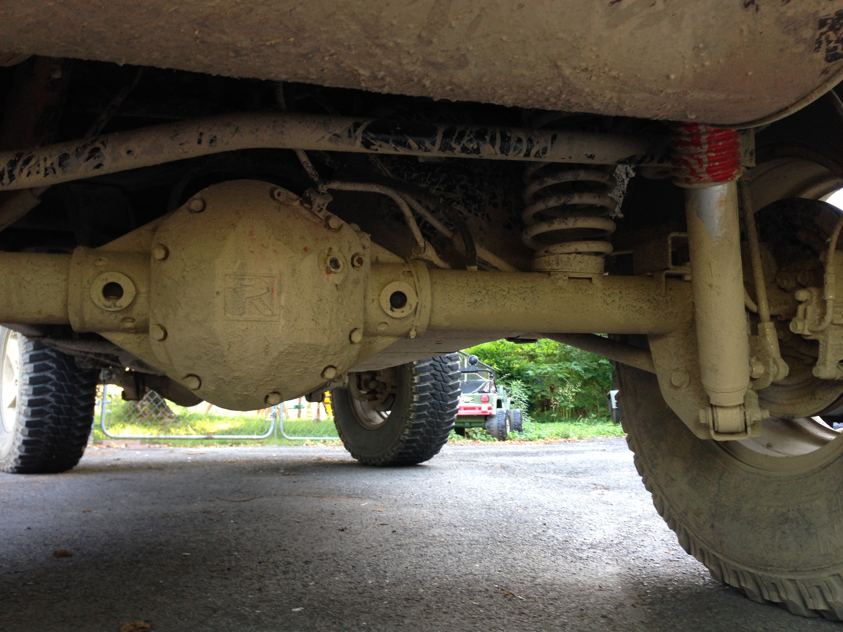

I've been running the Rancho RS9000XL for just over three years and 40,000 miles. I run (I think) 7 in front and 5 in back. I had to take the adjusters off a couple of years ago because they were getting hard to turn - cleaned off some grime/rust from around the plastic knobs and added some white lithium grease in and around the gasket area. They still work well and the adjustability is awesome. Rancho needs to use a better sealing gasket around those knobs, but otherwise they're great. Recommend installing the rear shocks so the knobs are facing forward for protection.
Attachment 676394Attachment 676395 |
