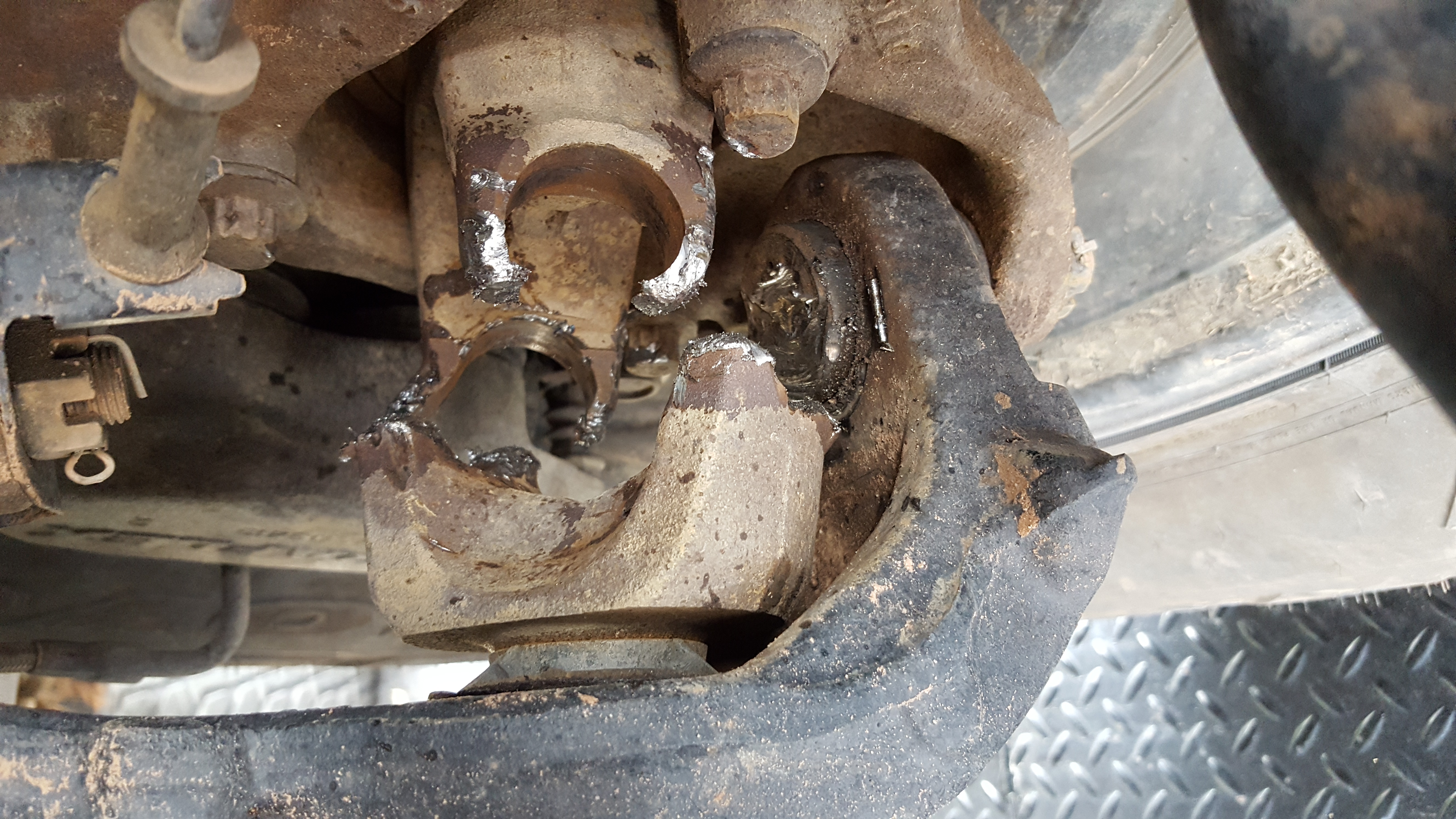

My Jeep has a Rubicon Dana 44 on the front with stock shafts and Teraflex Heavy Duty Ball Joints. I am looking at replacement shafts and found that Dana Spicer makes a Performance Front Axle Shaft that replaces the 1310 joints with 1350's.
The question is, will this shaft fit with the ball joints that I have or will there be interference? I have sent a request to TF, but no reply yet.

I am mulling over upgrading the 44 to better components vs. just getting a UD60. If I can find the $, then the 60 is it, if not, the RCV's that Jonathan is recommending is a good lower cost solution.

My Jeep has a Rubicon Dana 44 on the front with stock shafts and Teraflex Heavy Duty Ball Joints. I am looking at replacement shafts and found that Dana Spicer makes a Performance Front Axle Shaft that replaces the 1310 joints with 1350's. The question is, will this shaft fit with the ball joints that I have or will there be interference? I have sent a request to TF, but no reply yet. <img src="https://www.jk-forum.com/forums/attachment.php?attachmentid=658945"/>
They said that they MAY interfere and pointed me to the tech note to grind down the U-Joint if it does. Oh well. I think I am just going to put a set of new joints in it for the time being. Axles that is, not ball joints.

2012 was the cut-off point for when the axle shafts got upgraded on the front d44s. If you upgrade to the larger axle shafts and are running the TF ball joints, chances are you will have to grind.
Super Moderator
I'd think you would certainly have to grind down the yokes a little bit. I've got a friend that just put the TF bj's in his 15 rubi (stock shafts, but larger than the 10 shafts as mentioned above) and he had to address the yokes. He said it was "a bit" of grinding but I think that's all relative.
