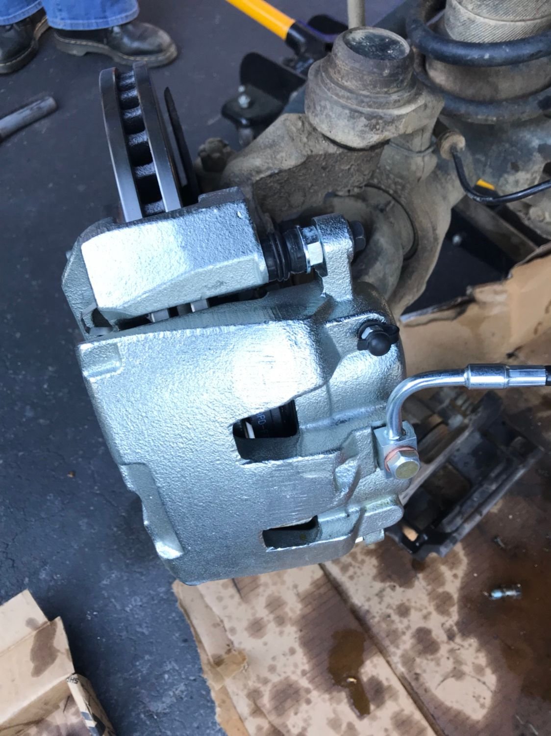

My brake lines are custom fit and go all the way to the calipers.

Boom. thats what I need.
I emailed a company for a quote... my local shop didn't have the right banjo fittings or bolts. Where did you get yours?
