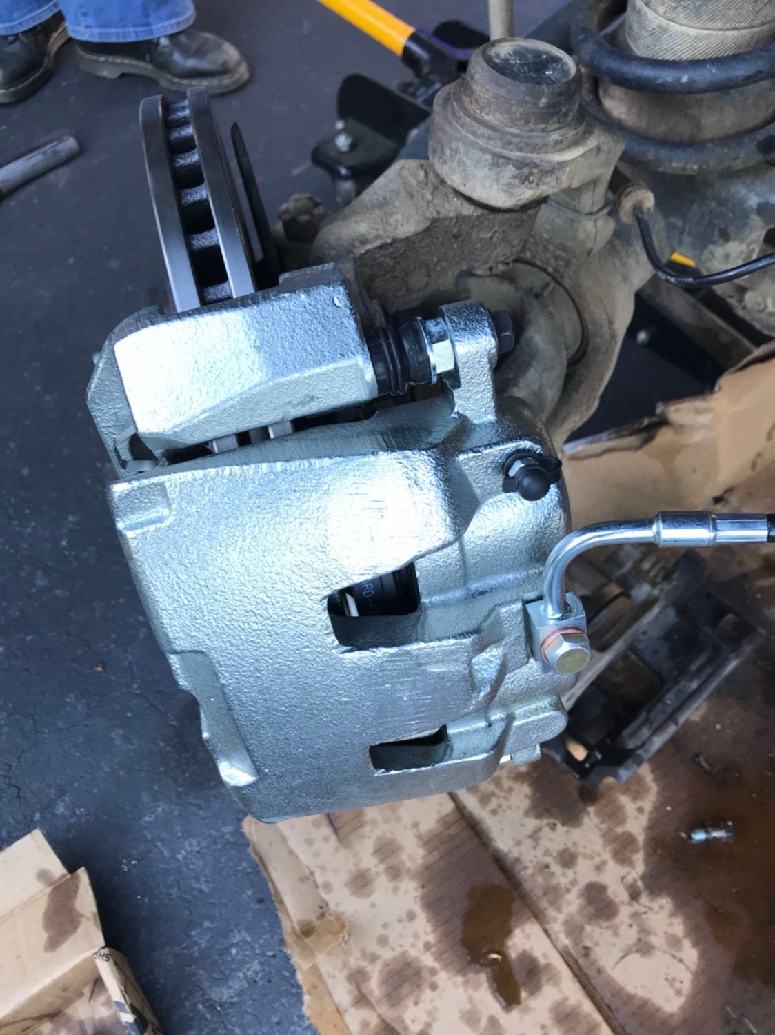

Ryan0260 Jan 28, 2018 08:57 AM
1 Attachment(s)
My brake lines are custom fit and go all the way to the calipers.
