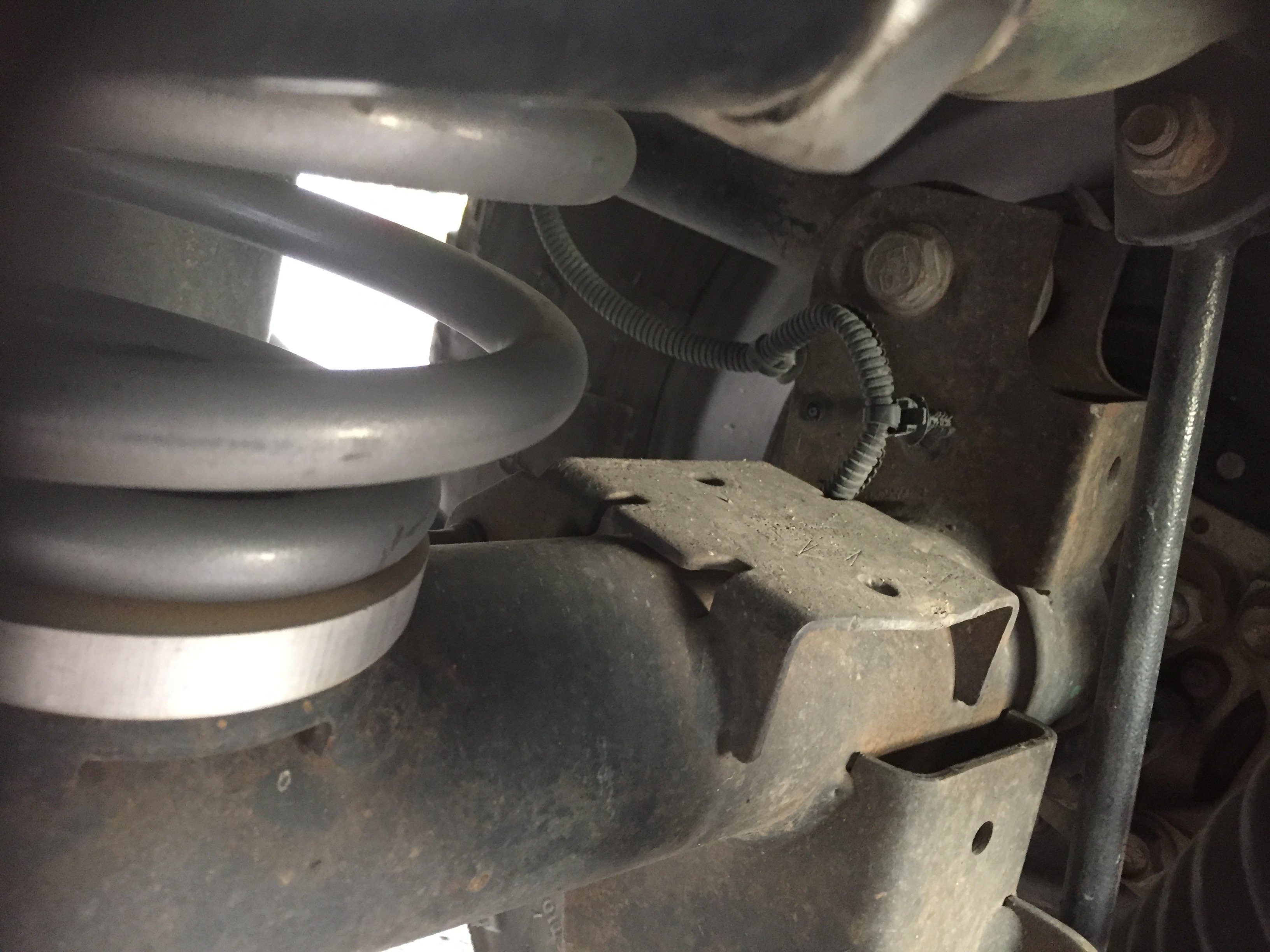

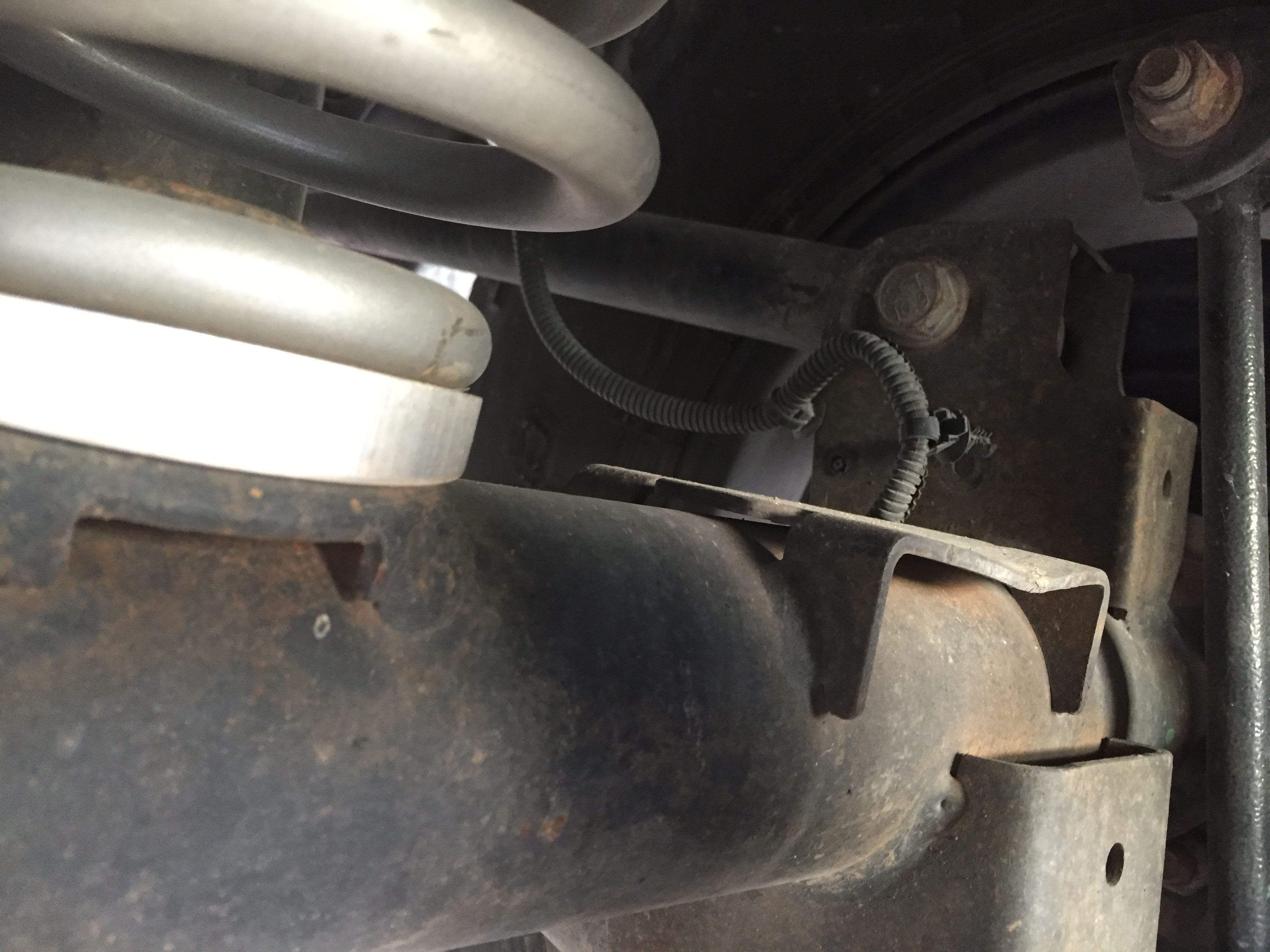

you are right and i was looking at sites for bump stops.
today i checked my JK and i saw on the rear axle,on the right point who i ll install the bump stop, a strong hit.
is this from a full flex? but i can't see anywhere where has bump it

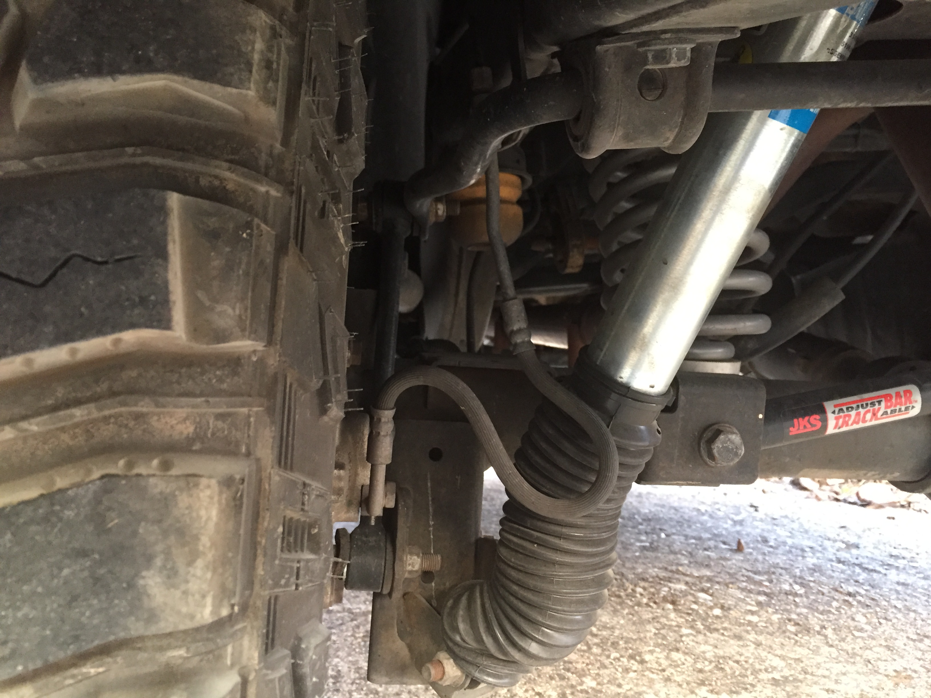

with FLEX connect in full flex the compressing of the rear shock is this:

That particular spot looks to line up with the bolt that runs through the other side of your track bar. I added bumpstops to mine but also notched that portion of the pad- not the correct way to fix the issue, but a fox nonetheless.
Speaking of which......4" and no raised mount in the rear? There's potential to tear that stock bracket from the axle. You will gain a better roll center and notice better cornering characteristics by raising it.
karls10jk is offline

you are right and i was looking at sites for bump stops. today i checked my JK and i saw on the rear axle,on the right point who i ll install the bump stop, a strong hit. is this from a full flex? but i can't see anywhere where has bump it <img src="https://www.jk-forum.com/forums/attachment.php?attachmentid=674227"/><img src="https://www.jk-forum.com/forums/attachment.php?attachmentid=674228"/> with FLEX connect in full flex the compressing of the rear shock is this: <img src="https://www.jk-forum.com/forums/attachment.php?attachmentid=674229"/>
That's nothing really compared to my bump stop pad. I ran no bumps after installing a 3.5" MC lift for one desert trip, and I bent my pad all the way to the axle tube. I hit a set of whoops at about 50 mph and we took a pounding inside the cab. Got home and realized I bent my pad. Stuck a crowbar between the pad and the axle tube and bent it back straight. Installed 2" bump stops and it hasn't happened again.
