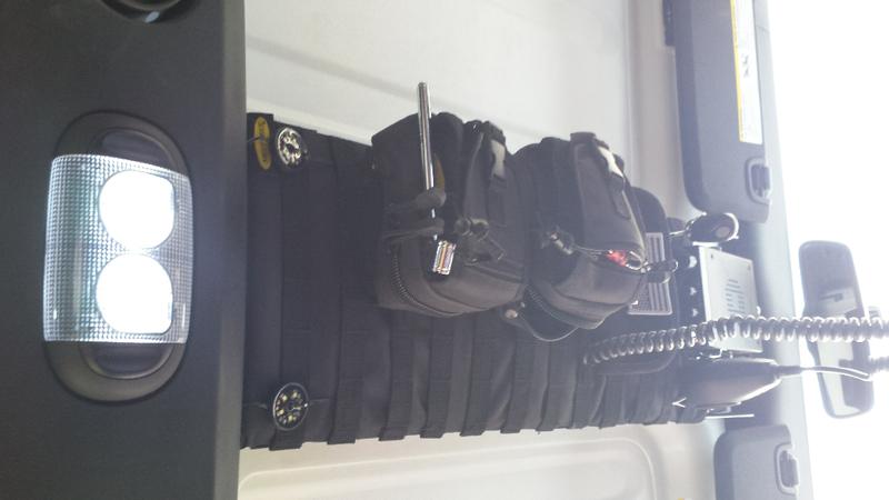

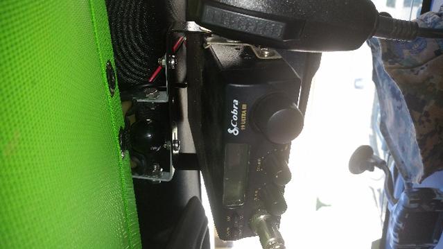

If that's the small one I saw on Google images, the loop above the mirror is a good place if you have a soft top. I used two small rubber lined c-clamps bolted to L brackets bolted to the bracket that came with my Cobra 19. I've also seen it attached to the side of the console where the passenger's knee is.
This ^^ works great for the Unidens. Get you one of those "sticky back" mic holders and you can stretch out the mic cord and hook it on the Freedom Panel to keep it out of the way and still have easy access to the mic

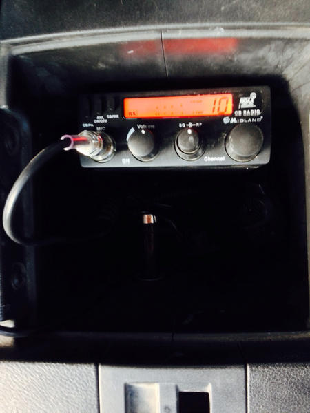

I mounted mine in the center console with some Velcro and used the plug in the center console to power it works great and is lockable. Only issue was I had to remove the plastic tray on the top part.
